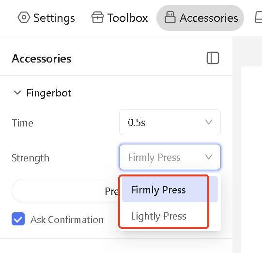

The Android app does not yet support Fingerbot, but this will be added in the next version. You can control Fingerbot through the KVM web interface.
Additionally, if pressing does not work, please first check if the installation is effective, and also try setting different pressing levels.
