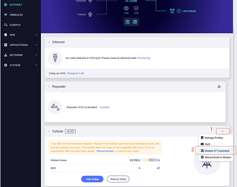

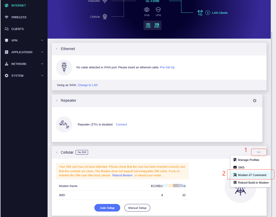

    INTERNET → Cellular → Three-dot menu → Modem AT Command → Manual Command
