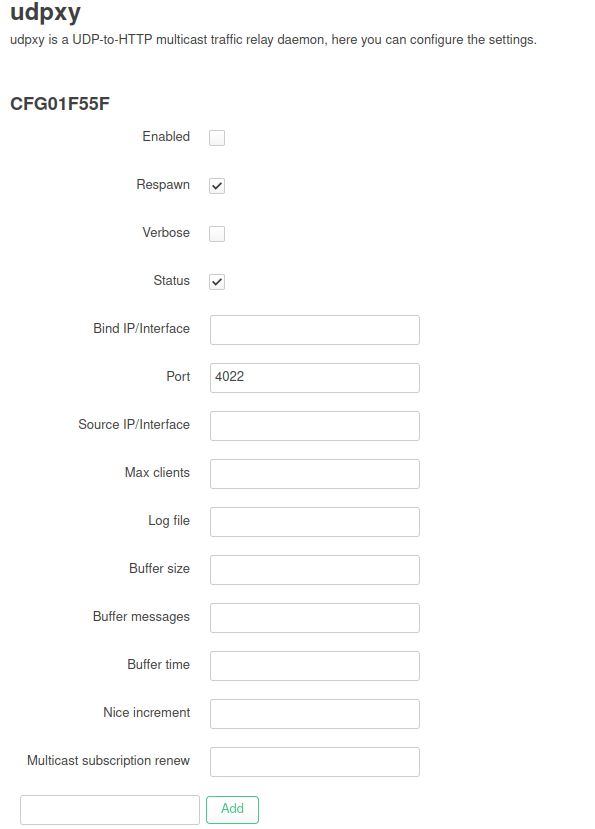

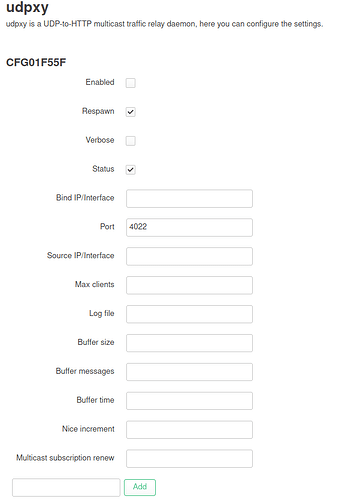

Multicast to unicast I couldn’t find directly as an option in luci however.
I searched a bit and came across the udpxy app for luci. Should do the job, but requires a bit of configuration.
