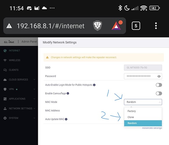

The mac clone option should be present either inside the repeater options, I think you have to click advanced there, I got also a Beryl 7 I can have a look tomorrow.

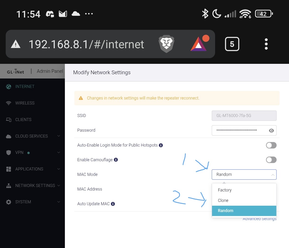

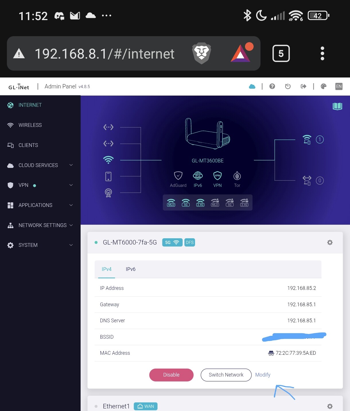

I have looked to my Beryl 7.
This how I do it for repeater modus:
I also have looked for mac clone when using ethernet, instead of the repeater options you click on ethernet options, from there you have mac mode which acts similar as the repeater function.

I think the Beryl 7 also has this feature but it is in the repeater settings like on my screenshot.
