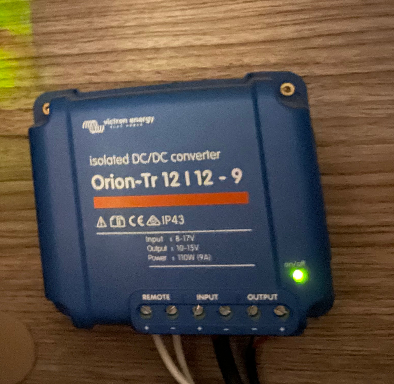

You should use Orion-Tr DC/DC converter between you're battery and your router
It's better for the hardware and you can switch it more easily.

What leads you to this conclusion? The input is specified to be 12-24V, so the regulator inside the device must be able to cope with this without a problem.
Must be able to cope with this without a problem over > 12V.
But voltages under 12V are not much of a problem for a LiFePO4-batteries - so you're right.
It's more an issue with AGM-type of batteries where the voltage is under 12V when the capacity is under 50 %.
