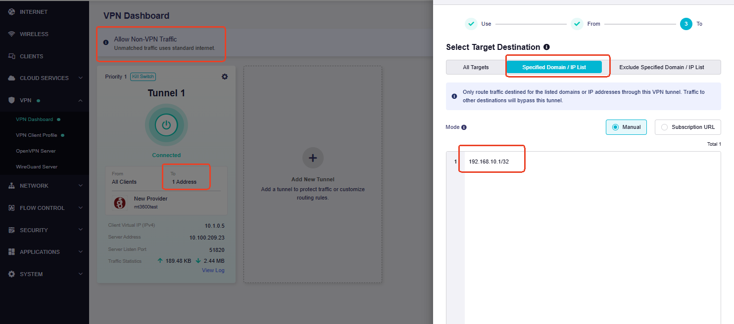

  1. Go to VPN → VPN Dashboard , and add or edit the WireGuard tunnel, under To , select Specified Domain / IP List , then add the IP address of your remote DNS server and make sure Allow Non-VPN Traffic is enabled so that traffic which does not match the above destinations continues to use the local WAN.
    For example: 192.168.10.1/32

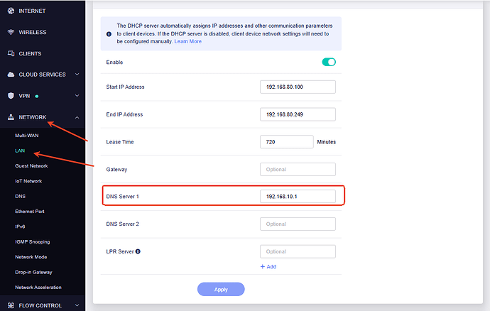

  2. Go to Network → LAN → DHCP Server → Advanced , and enter the remote DNS server IP in DNS Server 1 .
After applying the settings, reconnect the client devices to the router so that they can obtain the updated DNS settings through DHCP.

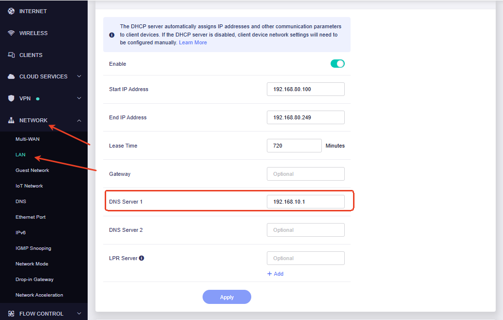

In this case, you can try using both DNS fields in the LAN DHCP settings.
Please keep DNS Server 1 set to your remote/HomeLab DNS server, which is already routed through the WireGuard tunnel, and set DNS Server 2 to a normal DNS server that remains reachable when the VPN server is offline.
For example:
  • DNS Server 1: your HomeLab DNS server
  • DNS Server 2: your Beryl 7 LAN IP or another normal DNS server
With this setup, when the VPN and remote DNS are available, the client should normally use DNS Server 1. If the remote DNS becomes unavailable, the client may fall back to DNS Server 2.
Please note that DNS failover behavior is handled by the client operating system, so the exact switching behavior and timing may vary between different devices.
