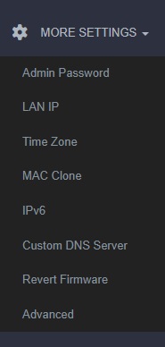

Above is a screen shot from the GL-B2200 web administration. As you can see there is no “Network Mode” settings. This is why I am asking how to turn the GL-B2200 into an access point because the traditional method for other GL.iNet routers does not exist on a GL-B2200.

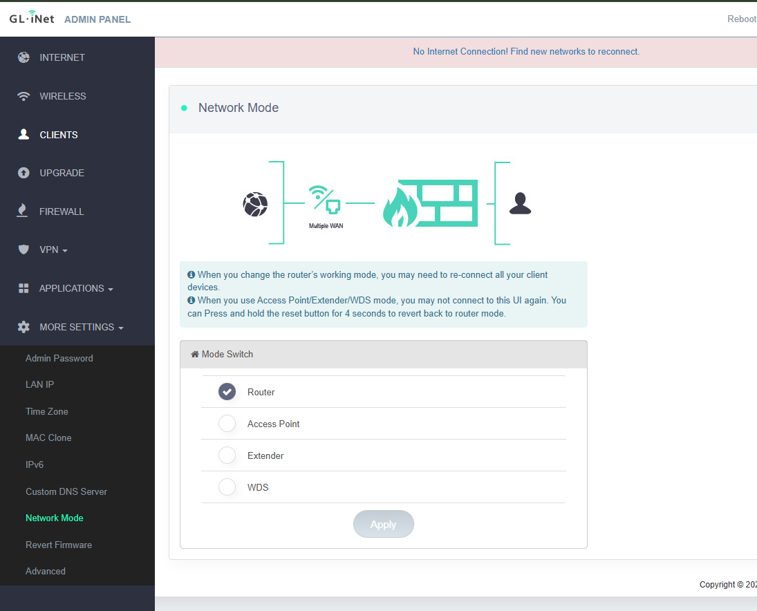

Please try updating the firmware to the latest stable version, v3.218.
It includes support for Network Mode – AP mode.

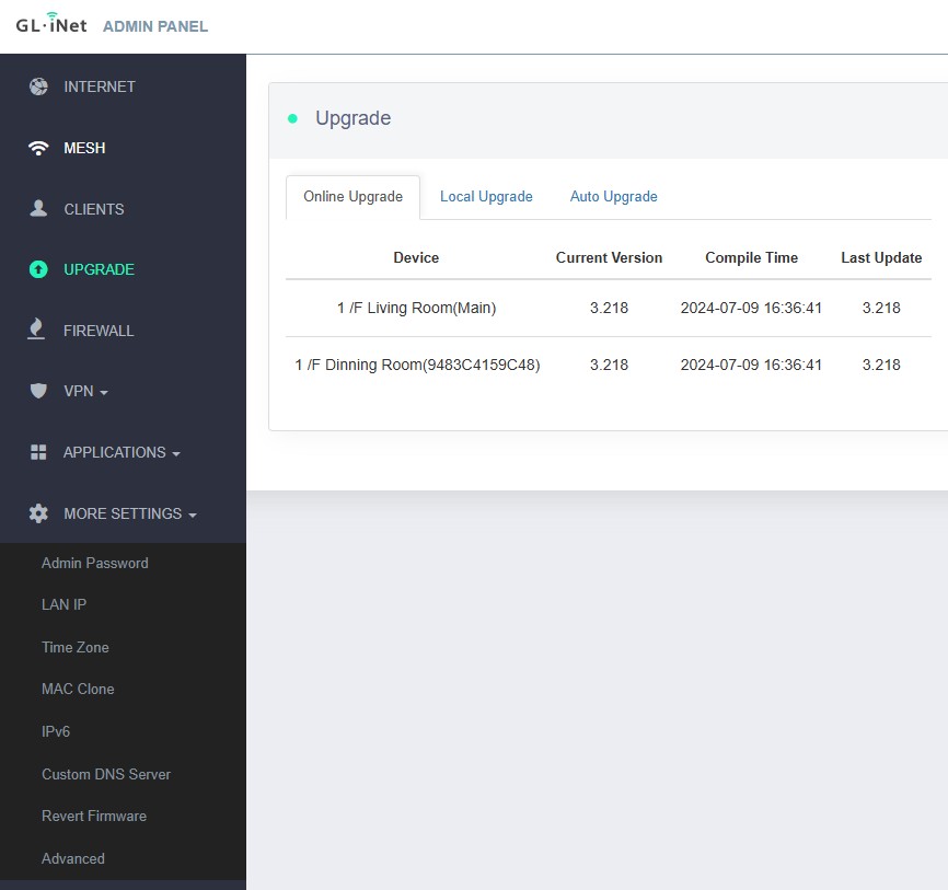

I also noticed it appears you are not testing on a B2200. I have a “Mesh” choice on the side panel and you do not which is unique to the B2200.
The main device was already at 3.218, I upgraded and was able to get the other node to the same level but still no “Network Mode” menu choice. Is there a configuration file I can edit to enable this option? I can ssh/sftp into the router if need be.
Your device appears to be in Mesh mode, which is why the Network Mode option isn’t available.

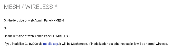

Please try resetting it and set it up using a wired connection (instead of the mobile app).

  1. Mesh mode and AP mode are different operating modes of the router, so they cannot run at the same time.
  2. If the B2200 has already been configured in Mesh mode, you will need to reset the device you plan to set as AP mode to factory settings and initialize it using a wired connection instead of the app. After that, you can find the Network Mode setting in the Admin Panel and switch it to AP mode.
