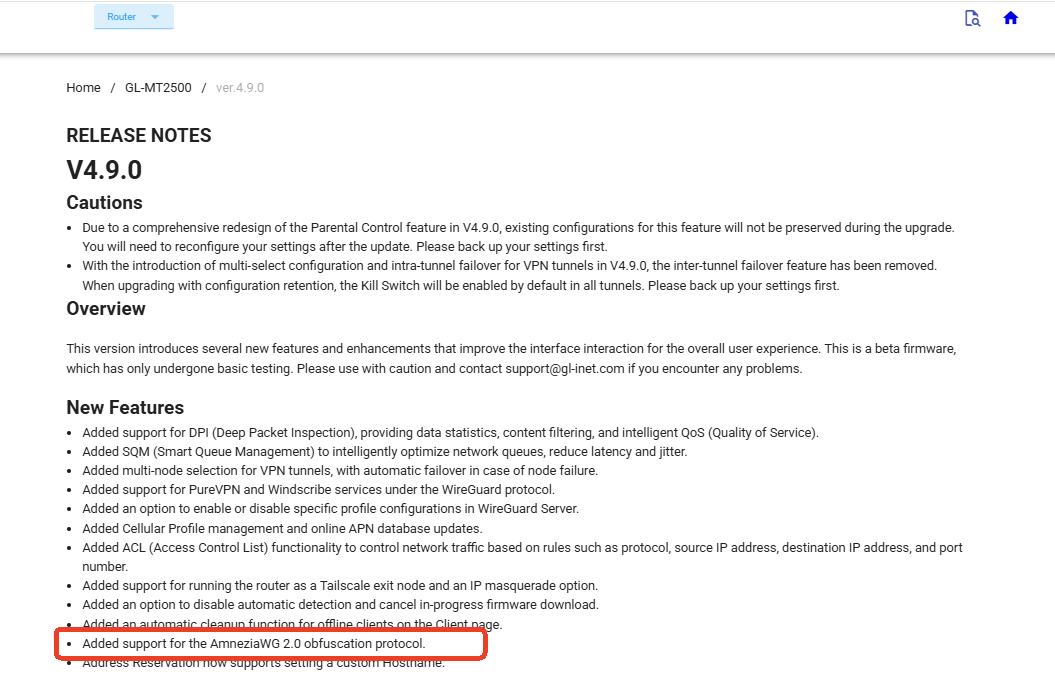

Currently, the GL-MT2500 v4.9.0 beta firmware supports the AmneziaWG 2.0 obfuscation protocol.

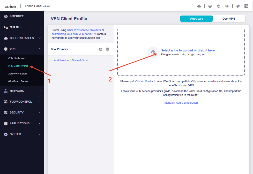

After upgrading your GL-MT2500A to firmware v4.9.0 beta, you can use the built-in VPN Client function to import your AmneziaWG configuration file directly.
It works perfectly. I had no problem setting the Amenzia VPN. Thanks!
