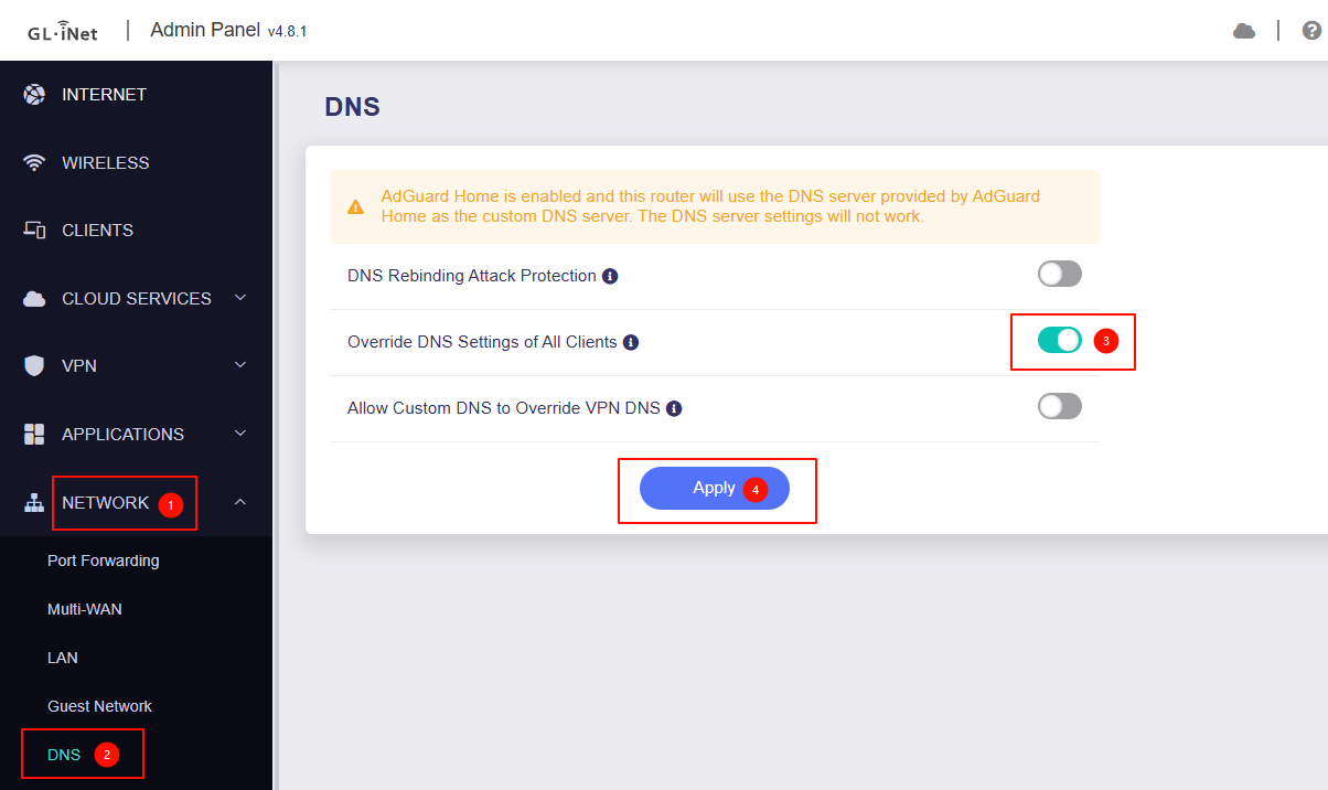

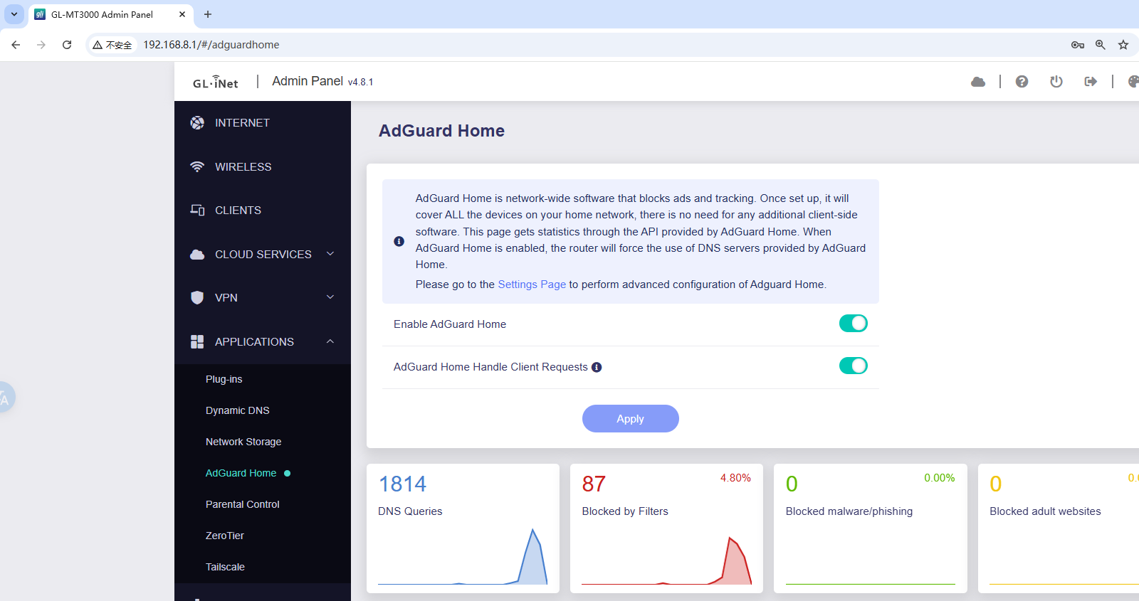

We tested on an MT3000 with firmware 4.8.1 snapshot (2025-08-20 19:29:07) and were not able to reproduce the issue — AdGuard Home is working normally.
Please note: if your client device is using other DNS servers instead of LAN IP address of MT3000, you will need to enable this option to force DNS requests through AdGuard Home:
