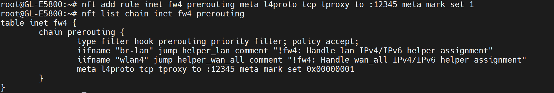

The TPROXY is already enabled at the kernel level, so it will not appear in lsmod .
Here is testing by adding the related commands and it works correctly::

I can confirm that the support is built into the kernel.
I just had to adapt my app to look into the kernel config instead of using lsmod.
