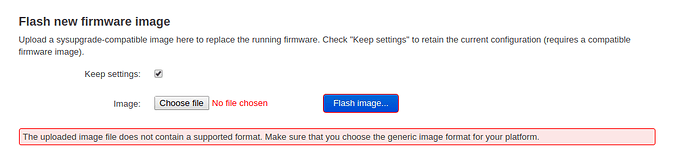

I followed the instructions here: [OpenWrt Wiki] GL.iNet GL-AR750S (under " OEM easy installation").
And used the current release linked here (gl-ar750s-squashfs-sysupgrade.bin): Index of /releases/19.07.2/targets/ar71xx/generic/
The uploaded image file does not contain a supported format. Make sure that you choose the generic image format for your platform.
I also tried openwrt-ath79-nand-glinet_gl-ar750s-nor-nand-squashfs-sysupgrade.bin but received the same erorr.

Hi @ganam25324 thanks for your repsonse!
I’m not quite sure what you’re saying - I understand the debrick tutorial but my router is on the latest GL firmware (3.101).

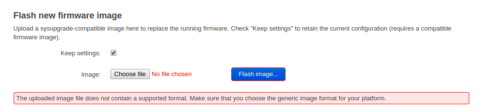

For both of the files (.bin and .img) you posted I get the following error:
I get the exact same error for the two .bin files you posted previously.
Thanks again!
that screenshot looks like luci, if it is not accepting image follow instruction in debrick tutorial and falsh snapshot factory image via uboot not luci:
https://downloads.openwrt.org/snapshots/targets/ath79/nand/openwrt-ath79-nand-glinet_gl-ar750s-nor-nand-squashfs-factory.img
cheers
Thanks! I understand now. I was able to flash with the img provided using the instructions above (Debrick via Uboot - GL.iNet Docs).
