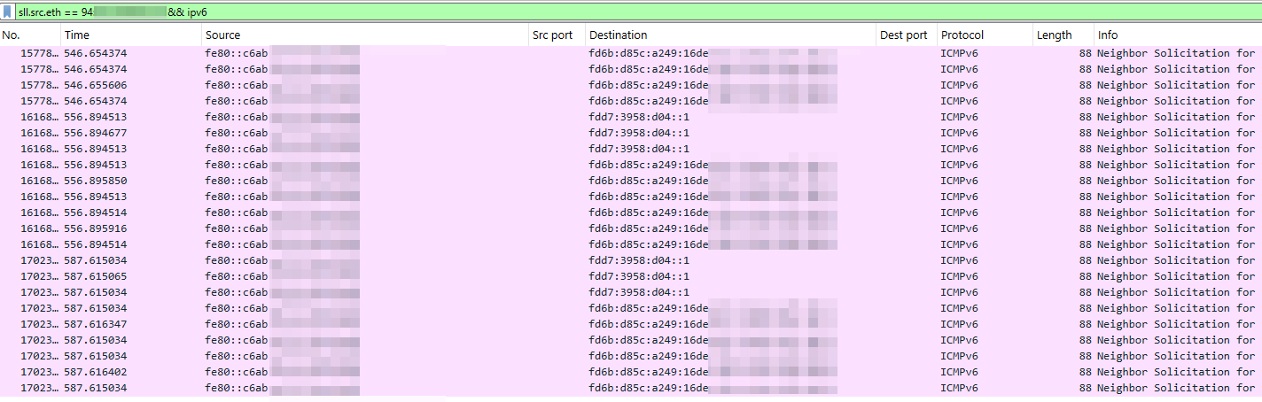

tcpdump capturing the guilty packets
16:33:58.577105 IP6 ::1 > 2620:149:a16:2000::521: ICMP6, neighbor solicitation, who has 2620:149:a16:2000::521, length 32
16:33:58.577141 IP6 ::1 > 2607:f8b0:4004:c06::bc: ICMP6, neighbor solicitation, who has 2607:f8b0:4004:c06::bc, length 32
16:33:58.577177 IP6 ::1 > 2607:f8b0:4002:c06::bc: ICMP6, neighbor solicitation, who has 2607:f8b0:4002:c06::bc, length 32
16:33:58.577213 IP6 ::1 > 2001:4860:4802:34::223: ICMP6, neighbor solicitation, who has 2001:4860:4802:34::223, length 32
16:33:58.577248 IP6 ::1 > 2001:4860:4802:36::223: ICMP6, neighbor solicitation, who has 2001:4860:4802:36::223, length 32
16:33:58.577285 IP6 ::1 > 2a03:2880:f203:c6:face:b00c:0:7260: ICMP6, neighbor solicitation, who has 2a03:2880:f203:c6:face:b00c:0:7260, length 32
Here you can see your MAC address (the Flint 2 br-lan MAC)
sudo tcpdump -ni re1 icmp6 and 'icmp6[0] == 135' -vv**
      0x0000:  9483 c4a7 2e24
16:47:06.960183 IP6 (hlim 255, next-header ICMPv6 (58) payload length: 32) ::1 > 2603:6081:8100:324e:5207:c3ff:fe99:d252: [icmp6 sum ok] ICMP6, neighbor solicitation, length 32, who has 2603:6081:8100:324e:5207:c3ff:fe99:d252
      source link-address option (1), length 8 (1): 94:83:c4:a7:2e:24
16:47:06.960219 IP6 (hlim 255, next-header ICMPv6 (58) payload length: 32) ::1 > 2603:6081:8100:324e:b197:f9b9:e73:e990: [icmp6 sum ok] ICMP6, neighbor solicitation, length 32, who has 2603:6081:8100:324e:b197:f9b9:e73:e990
16:47:06.960256 IP6 (hlim 255, next-header ICMPv6 (58) payload length: 32) ::1 > 2603:6081:8100:324e:c4af:d43b:f511:a20a: [icmp6 sum ok] ICMP6, neighbor solicitation, length 32, who has 2603:6081:8100:324e:c4af:d43b:f511:a20a
… repeats ad nauseam

We have conducted a preliminary local check. By enabling IPv6 in the Admin Panel as previously mentioned, the device no longer sends NS (Neighbor Solicitation) requests externally using the ::1 address. During our 10-minute test, it also did not switch back.
Regarding the ::1 issue, we have successfully reproduced it locally and will be investigating it further with our R&D team.
