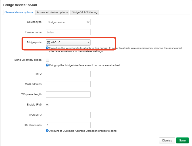

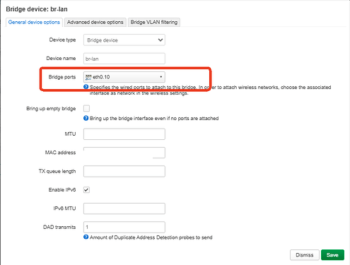

  2. Go to Network -> Interfaces -> Device -> br-lan
  3. Create another interface for VLAN 20.

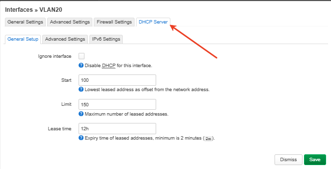

    Enable DHCP server on both interfaces to assign IP addresses to both networks.

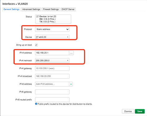

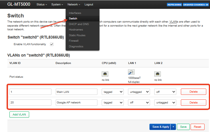

  1. Create an internal VLAN for the Google AP port. Go to Network -> Switch.
    Configure the switch VLANs like this.

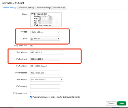

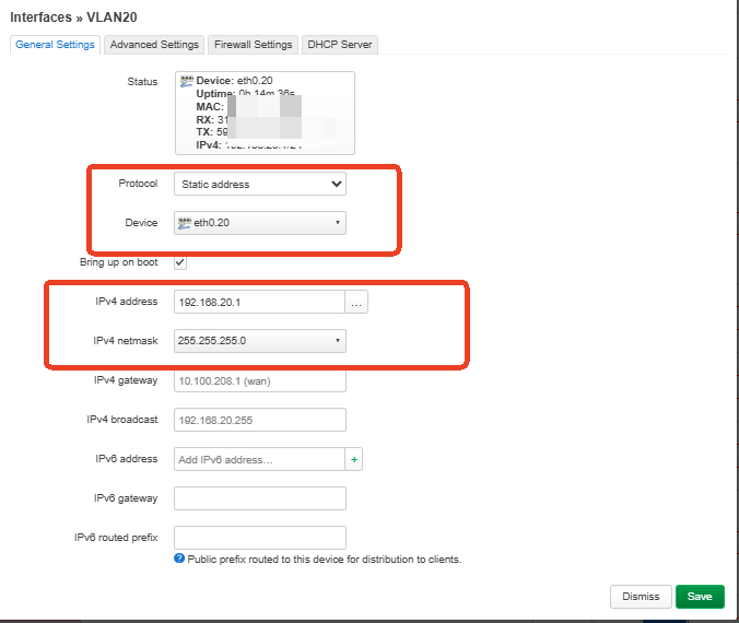

  2. Create a new interface for the Google AP network. Go to Network -> Interfaces -> Add new interface.
    If the Google AP is used as a pure access point, disable DHCP on the Google AP.

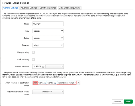

  3. Configure firewall isolation. Create a new firewall zone for the Google AP interface.
After configuration, clients behind the Google AP should get 192.168.20.x addresses.
Normal LAN devices should stay in the main LAN subnet, such as 192.168.8.x.

For your use case, the best option is to use the two physical LAN ports as separate access ports.
For example, LAN1 can be used for the main LAN, and LAN2 can be used for the Google AP network.
Configuration example:

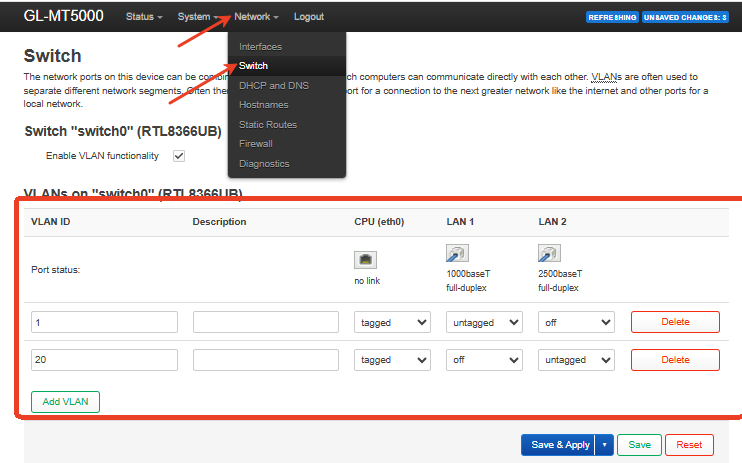

The LAN ports on Brume 3 are connected through an internal switch chip, so they need to be assigned to different internal VLANs before they can work as separate networks.
  1. Go to LuCI -> Network -> Switch.
    After this configuration, Brume 3 will see the two networks as separate interfaces.
    Then we can assign different IP subnets, DHCP servers, and firewall zones to these two interfaces.

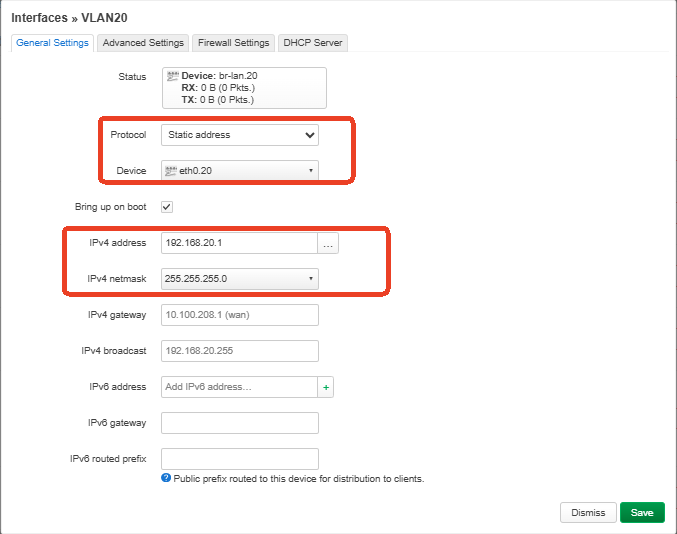

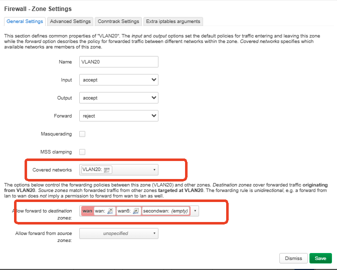

    Then save&apply.
With this setup, the Google AP network and the main LAN will be placed in two different subnets.
It isolates the two LAN ports by using separate subnets and firewall zones.

For a stricter setup, set the LAN2 firewall zone to Input: reject, Output: accept, and Forward: reject, while keeping forwarding from LAN2 to WAN enabled.
This will prevent devices on LAN2 from accessing router management services. In this way, LAN2 can be used as a guest or IoT network.
