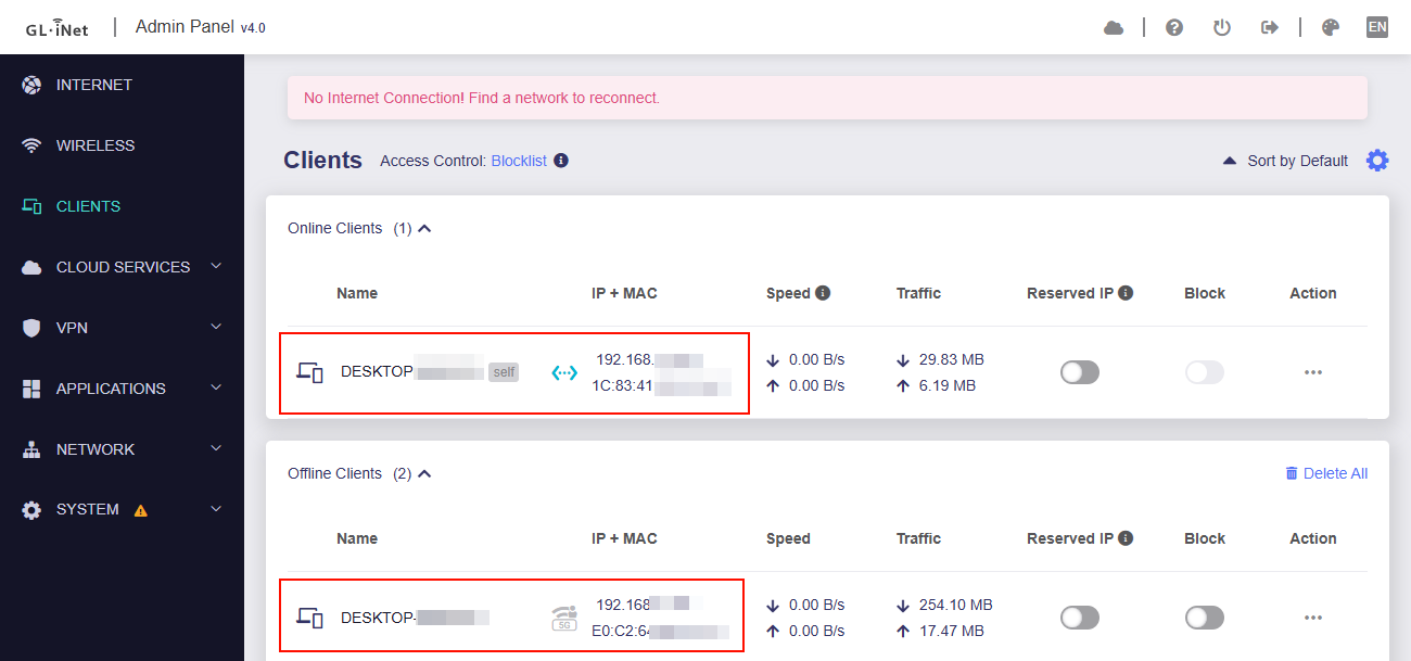

A related issue is that my router is saying my client (laptop), connected via wifi is using a randomised MAC. But I did not specify a cloned address on my laptop, which I do in Gnome settings > Wifi > (myssid) > cloned address. The field is empty, which normally means it’s using the default mac. But my wlan mac as shown in ip addr is indeed different to the address shown in clients.

Regarding the mismatch between the Clients page and the actual IP/MAC address of the connected device, please check/try the following:
  1. Make sure the device (e.g., your laptop) is connected only via Wi-Fi and not through other interfaces (such as Ethernet or a second wireless adapter), otherwise the Clients list may show multiple entries for the same device.
  2. Use Wireshark to capture traffic and verify the actual MAC address being used.
