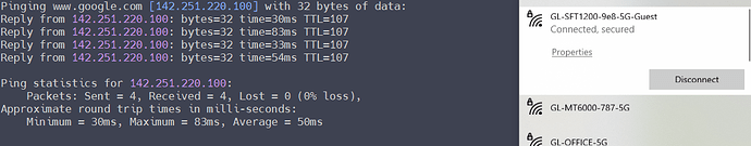

The guest wifi on the MT6000, is working well which mean Internet access normally in my phone/laptop.

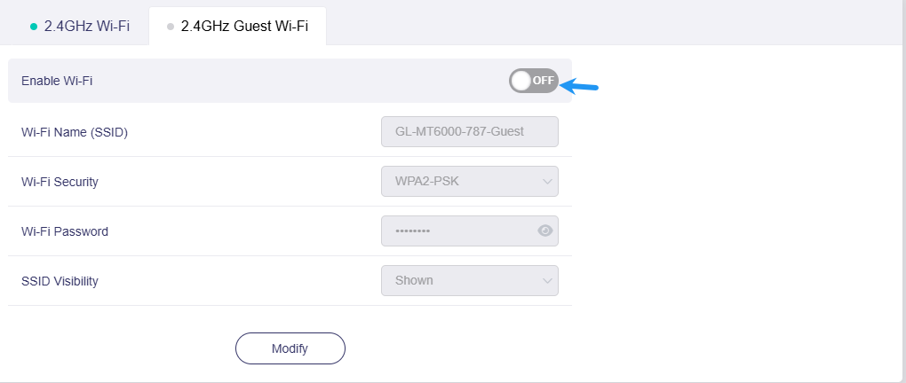

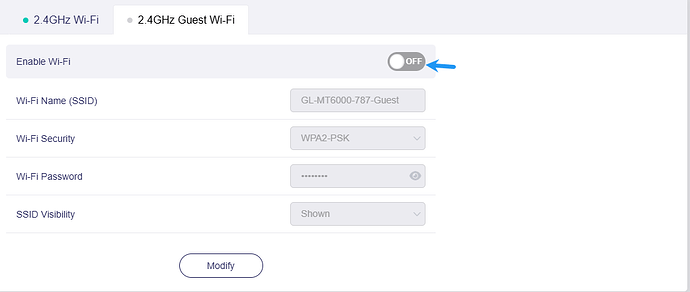

I finally had it working some hour ago... it was when I tried with the gateway 192.168.9.1 address instead of the main. But before that I had allways tried activating the guest2G by the toggle button and a script ... and after succeeding, I then tried again with the toggle button, and I got the guest2G but without the internet on it ![]()
So I am on this now : internet works if I activate guest2G by the web interface, but not if it is by the toggle button.
