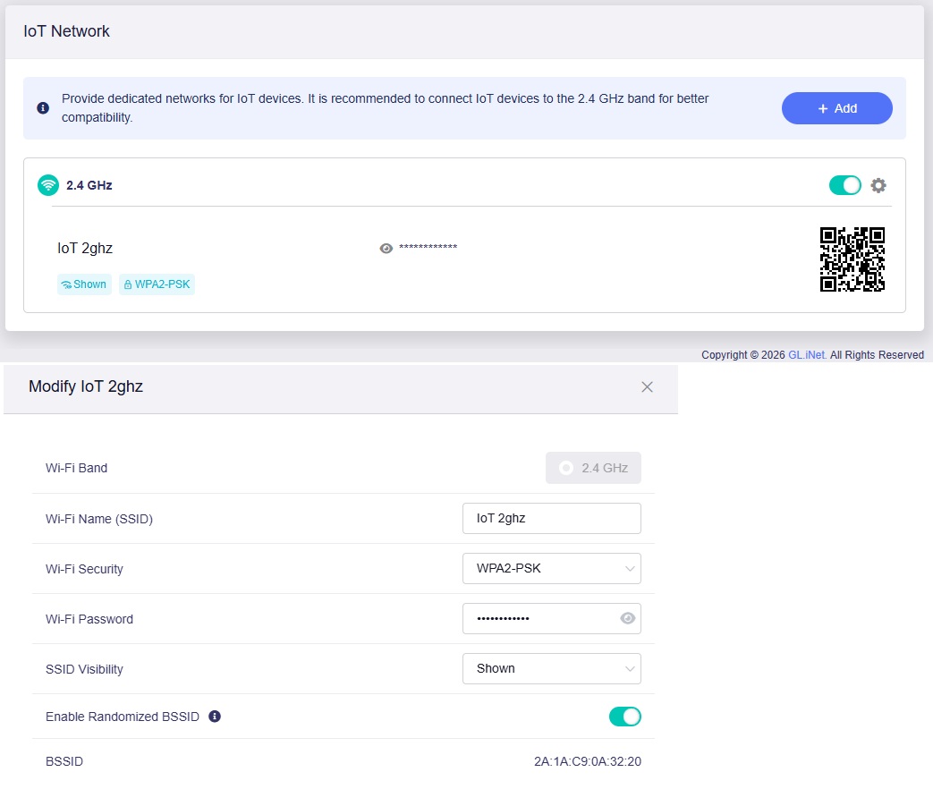

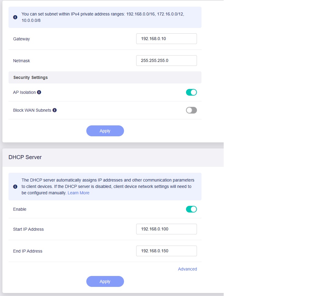

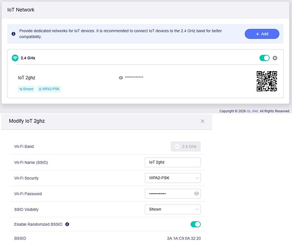

So as far as im aware ive set everything up correctly on the Flint 3, however, as you can see, the IoT network name ive set is not appearing on any devices to connect the devices to the IoT network ive created., have I done something wrong ? or any solutions ?
In fact ive just enabled the normal 2.4ghz channel which is normally disabled as I only use the 5ghz and 6ghz band and thats not showing on any devices either, its like the 2.4ghz isnt working at all.
Can you check under luci → wireless if the wifi radio appears and what is its status?
I managed to fix this in the end, strange, but tried a factory reset on the router, that didnt work, so I reflashed the firmware (4.9.0) and unchecked keep settings, and that seemed to fix it.
