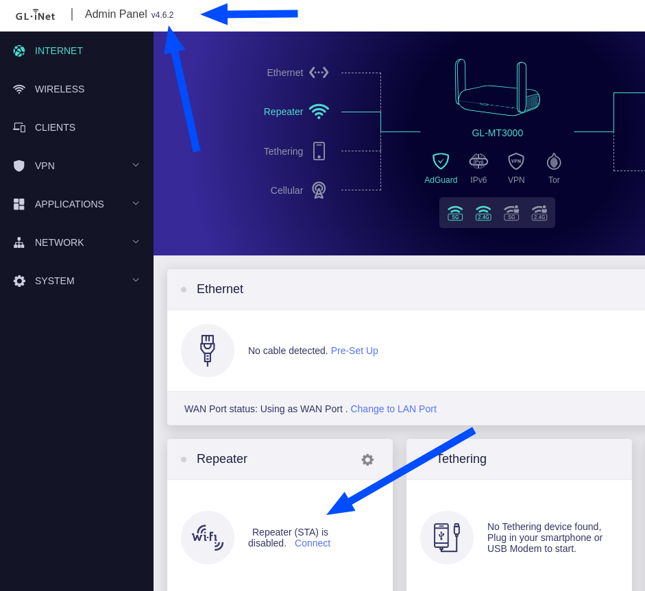

Ok, I ended up upgrading to 4.6.2 despite the release notes looking like the 4.6.0.

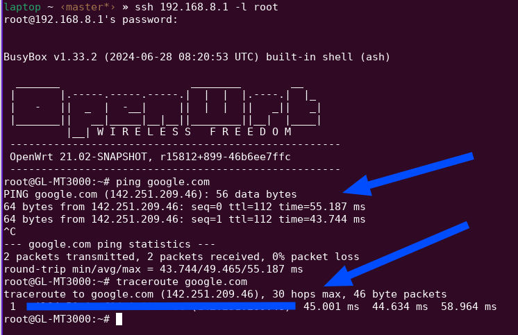

It is now showing NO repeater connection
while it is actually connected and working. See from SSH:
This is quite confusing.

Can you post the content of /etc/config/wireless
The issue at the moment "solved itself" without any intervention. After about 20 minutes the Web gui started to behave as expected.
Possibly clearing the browser cache would have worked too.
