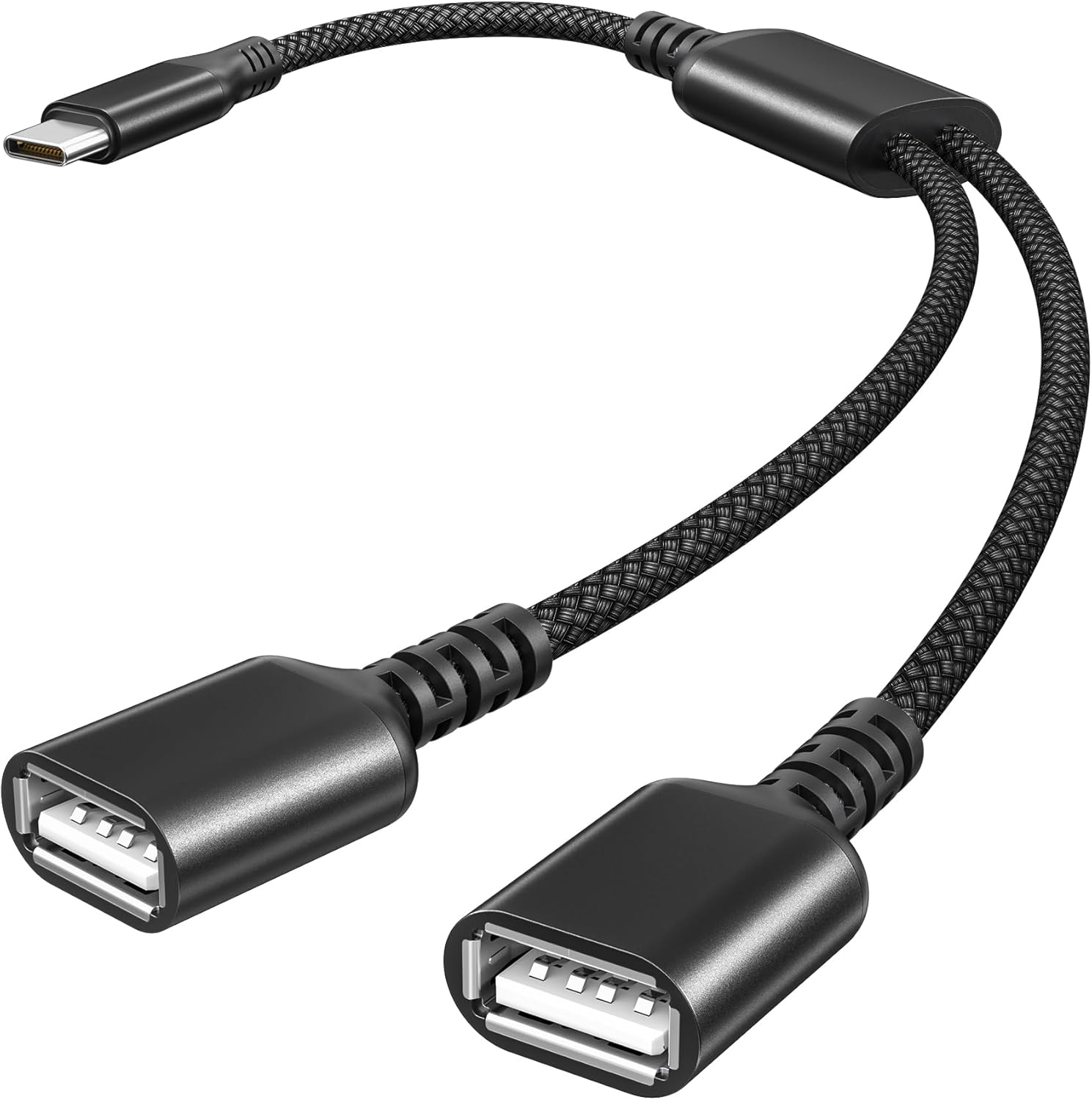

Is the solution then would be to attach a split usb cable to connect one too keyboard and one for the mouse ?
nope, I should say I haven't conducted extensive testing on this type of KVM switch, but based on the samples I've purchased for testing, we basically don't support this kind of KVM switch.
You can find their supported list in the PIKVM documentation. It seems most KVM switches are controlled via UART.
