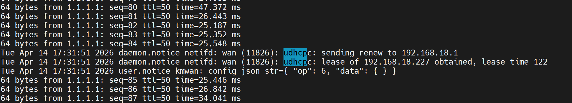

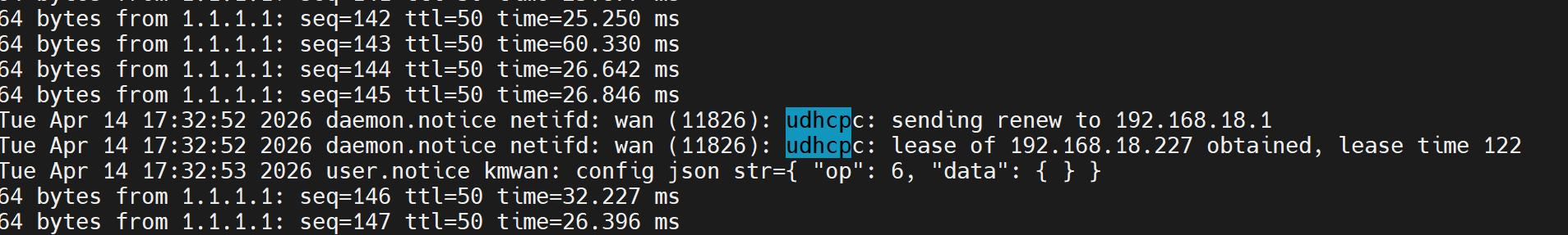

We ran a test locally using Flint 2 + v4.8.3 with your configuration settings, but we were unable to reproduce the issue.
As you can see from the log entries below, the ping connection did not drop before or after the DHCP renewal, the WAN interface did not go DOWN and UP, and there were no relevant messages after disabling kmwan:
You might try SSHing into the router and using the following commands to completely disable kmwan to see if that helps:
/etc/init.d/kmwan stop
/etc/init.d/kmwan disable
If the issue persists, please export the device logs and send them to us via private message so we can analyze them.
