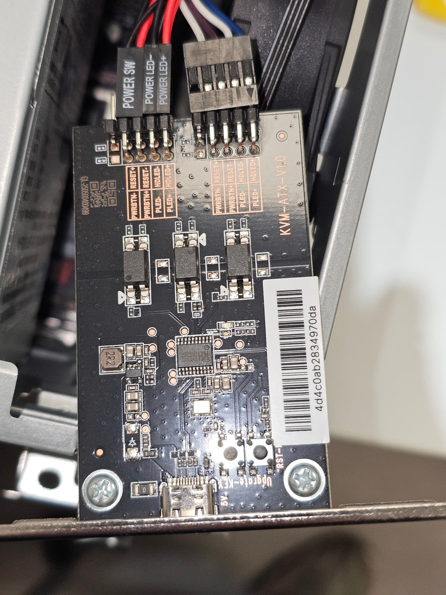

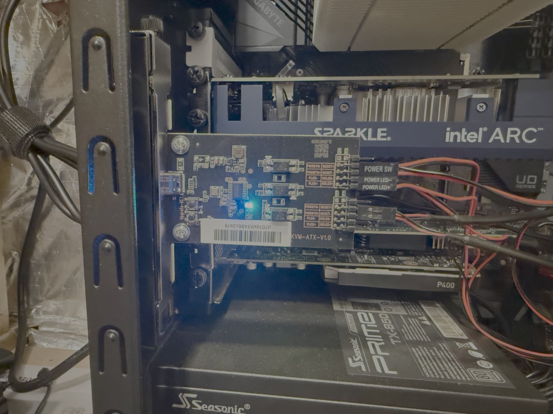

@Kyrie i have contact with CS stuff team. Fedex want to pickup two times the rma board. i asked cs stuff member daisy for the needed rma label or qr code but i never got answer from your stuff. In the meantime i ordered two atxboards from amazon.de. i tested both on the same pc where one of the two atxboards from first order works perfect. Both atxboards from new amazon.de order have the same error power switch does never work. Are there maybe different hardware revisions available? What else can i do? Attached are pictures from the one which works.

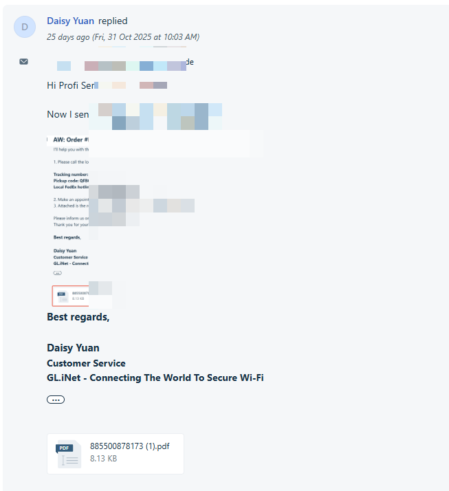

got two mails from daisy but unfortunately there wasnt an rma label or qr code attached. I responded on the second (30.10.) but never got answer maybe really a mail problem…
There was PDF files attached to the email. Could you please double-check if the attachment was missing from the email you received?
i searched the old mail now again but there is unfortunately no pdf attached. At the moment i got a new mail from your stuff but again the pdf ist missing.

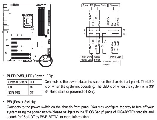

That is correct. My thoughts as well. The board in the non functional system is a GIGABYTE B760M DS3H DDR4.

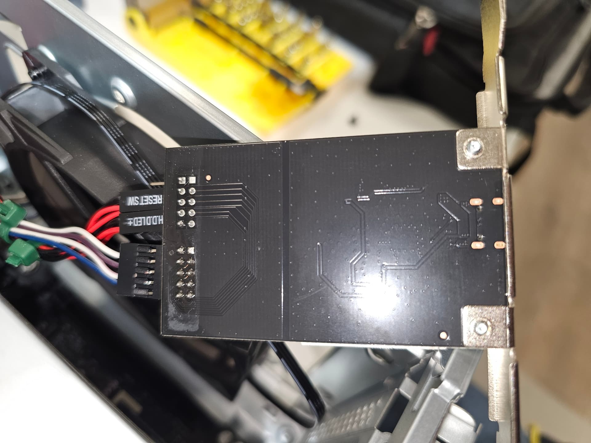

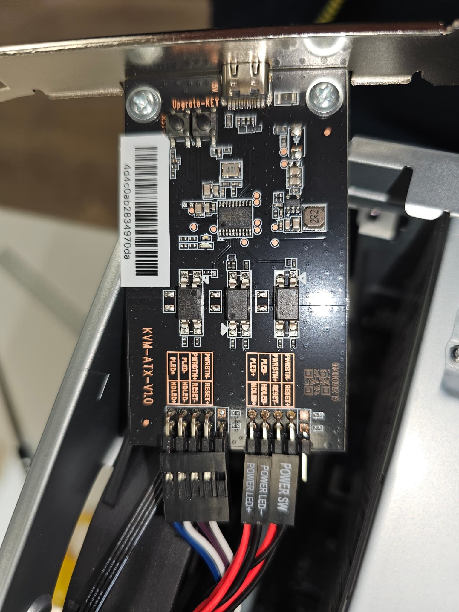

I finally had a chance to get back to this, I flipped the cable around like the other user and then reversed the polarity and it worked. However, now I'm still not getting the case button LED to light up. Any other recommendations?
