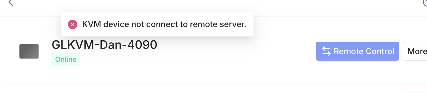

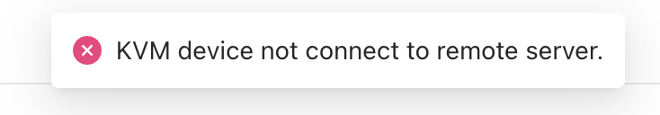

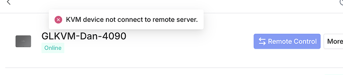

"KVM device not connect to remote server." through glkvm.com
I am able to access my cloud device through the MacOS app, however through glkvm.com I am getting the error message “KVM device not connect to remote server.”
Is there some router setting I’m missing? Weird that one lets me access while the other does not…
