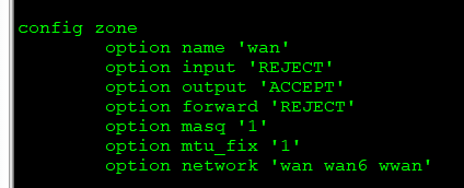

That’s strange - afraid I don’t know enough about the factory firmware extras and frontend to debug easily. I wonder if it was firewall related? There are wan and lan ‘zones’ in /etc/config/firewall; would the web front-end know to add the l2tp interface to the wan zone?
Hi,you can confirm this, look at the configuration of /etc/config/firewall
Hi, this shows wan, wan6 and wwan interfaces in the ‘wan’ zone. Is the l2tp one of these three? If not, possibly it needs adding here in the ‘option network’ line.
