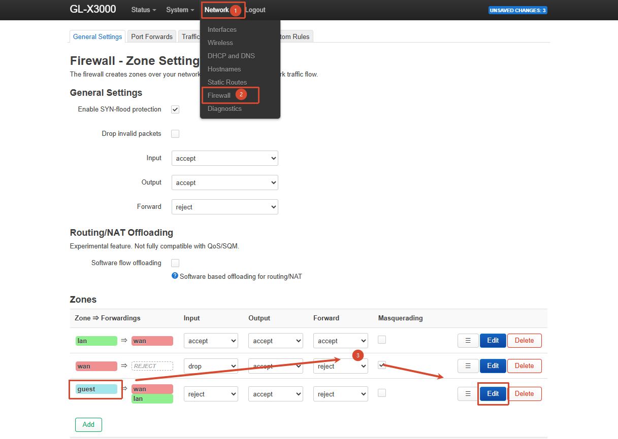

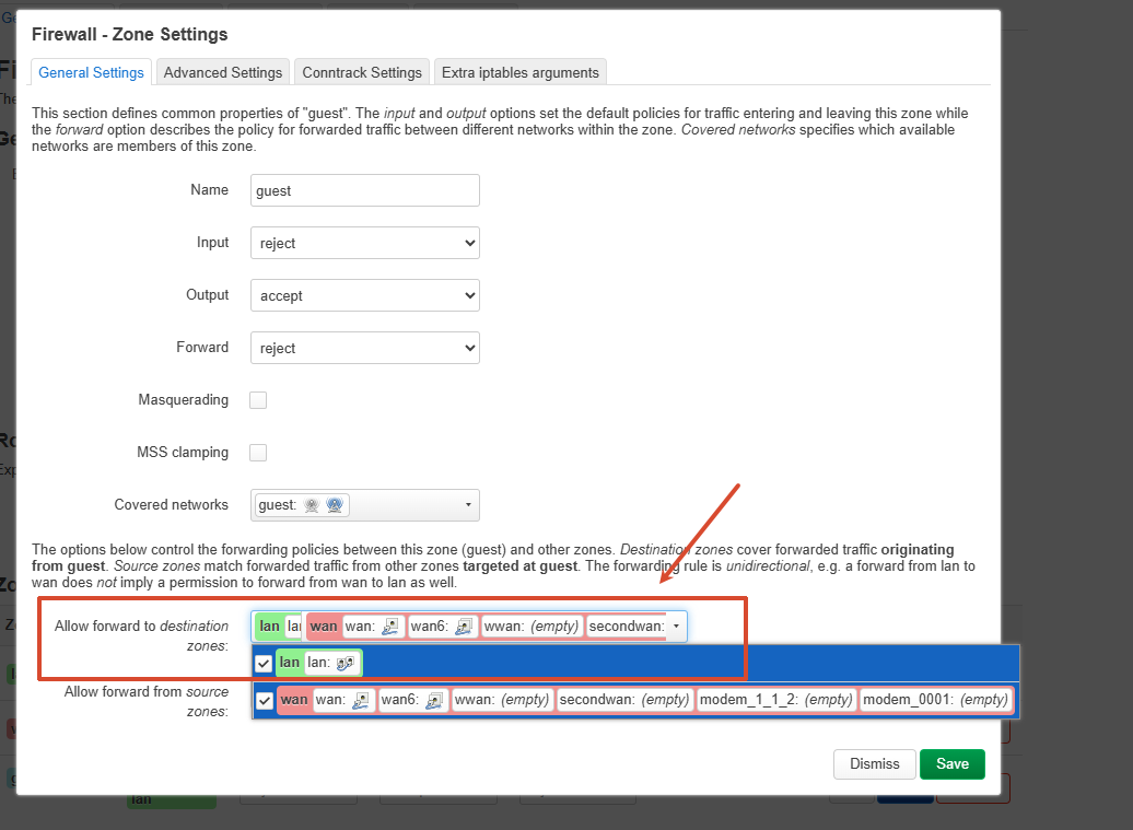

However, if you would like to allow it, you can enable forwarding from Guest to LAN under LuCI → Network → Firewall:

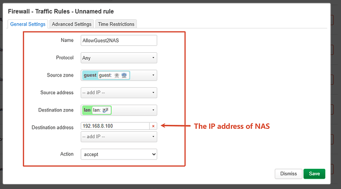

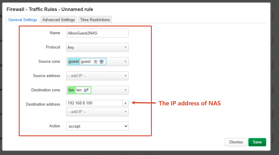

If you only want to allow Guest access to the NAS:
