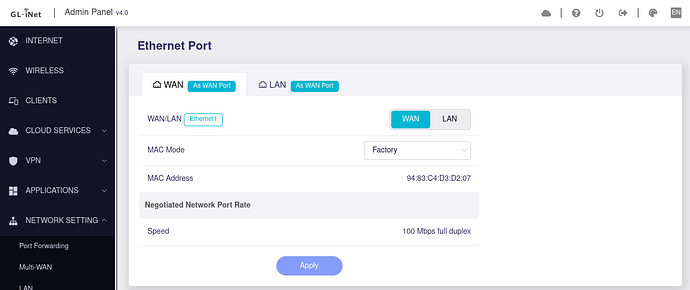

When you connect the X3000 to the TL-SG1024DE and directly to the Workstation, could you please check NETWORK → Ethernet Port and let us know what speed is shown under Negotiated Network Port Rate in each case?

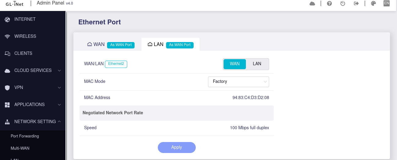

Also, does the same 100 Mbps negotiation occur on both physical Ethernet ports — the default WAN port, and the LAN port when it is switched to WAN mode?

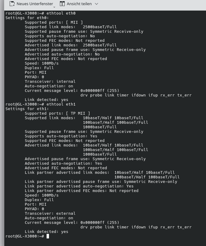

If convenient, could you please SSH into the X3000 and share the complete output of the following commands:
ethtool eth0
ethtool eth1

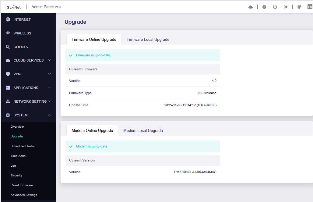

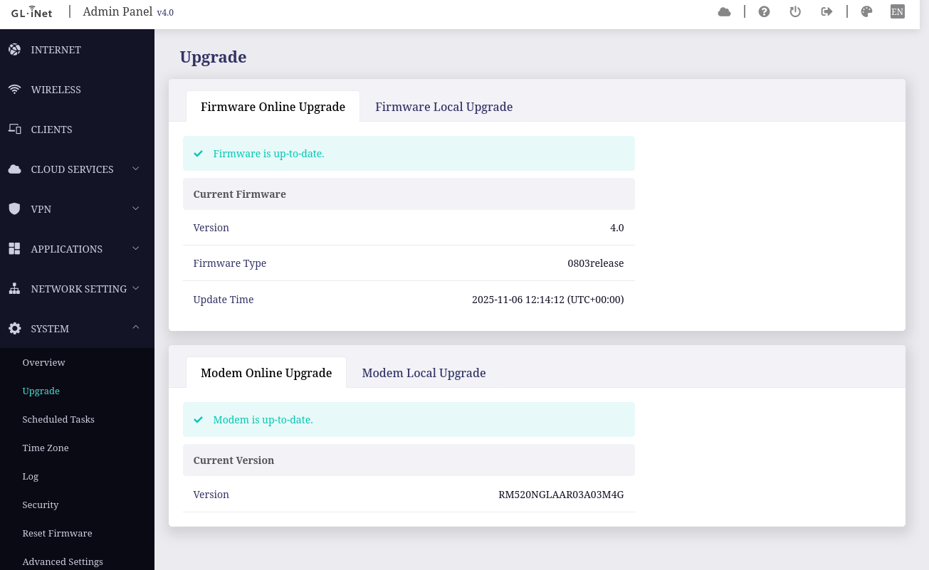

Please also let us know the complete firmware version currently installed on the X3000.

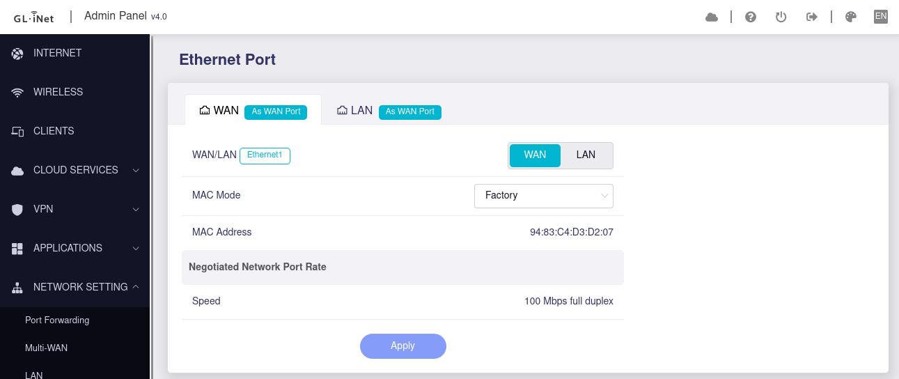

WAN
Negotiated speed is alway only 100Mbps
LAN

Firmware is the latest (stable) available:
same result with ethtool (WAN as WAN and LAN as LAN):

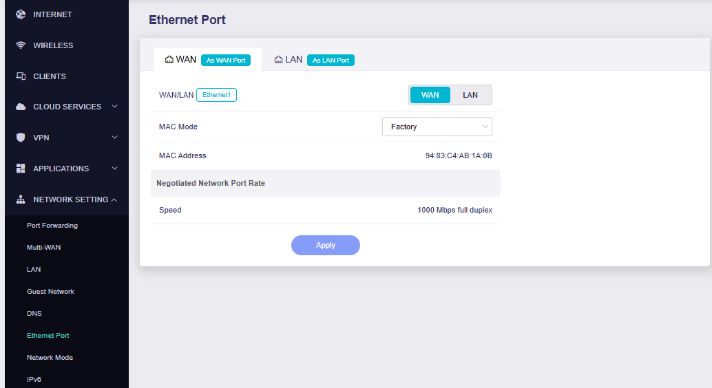

But, when connecting the same workstation with the same cable to the TL-SG1024DE (same port the router was connected before) its 1000Mbps

Thanks for the detailed test results.
From the screenshots and ethtool output, we can confirm that both Ethernet interfaces are currently establishing the link at only 100 Mbps full duplex.
