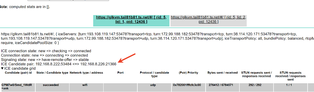

chrome://webrtc-internals/
You can see how it actually establishes a connection through this in the browser.
webrtc internal logs attached. unfortunately its too much for my comprehension :frowning:
webrtc logs.zip (2.7 MB)
See this .This line indicated what IP address your browser may connection with GLKVM. It’s a local area network IP address, so your connection must be using local area network.
