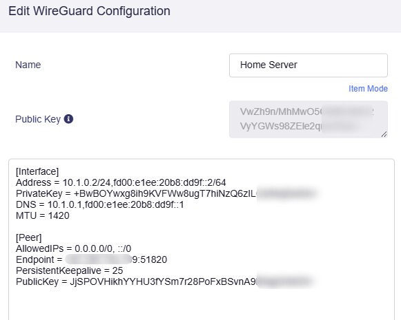

The config in my MT3000:
[Interface]
Address = 10.6.7.2/32
PrivateKey = snip
DNS = 10.6.7.1
MTU = 1420
[Peer]
AllowedIPs = 0.0.0.0/0
Endpoint = snip.ddns.net:4443
PersistentKeepalive = 25
PublicKey = snip

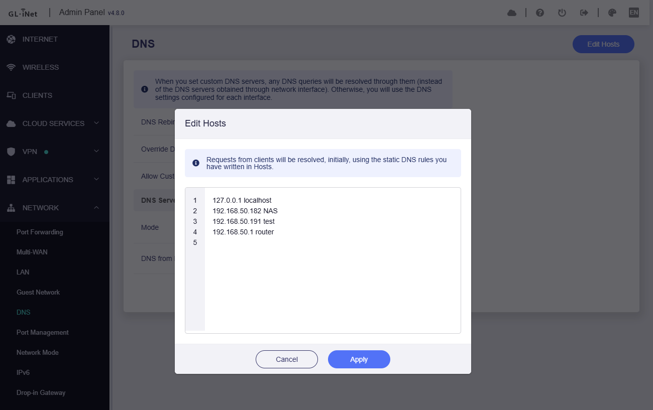

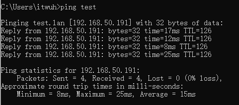

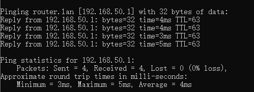

I just tried to understand what you mentioned and then I tested it locally, it seems like there is no problem with client to server for DNS 53
Simulate VPN server and add custom domain to hosts (192.168.50.0/24 are the LAN clients under the server)
MT3000 as VPN client, connect to VPN server and set profile DNS to server tunnel IP (64.6.64.6 removed)
The client PC under MT3000, ping the domain and reachable, indicating that the VPN client can obtain DNS resolution from the VPN server, so 53 DNS has no exceptions.

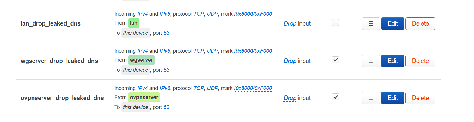

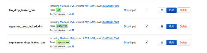

even when this settings has been set active:
when I observe the fw rules I see this:
would this be a remnant of the vpn policies which otherwise should be deleted?, I unchecked the lan_drop_leaked_dns and it works.

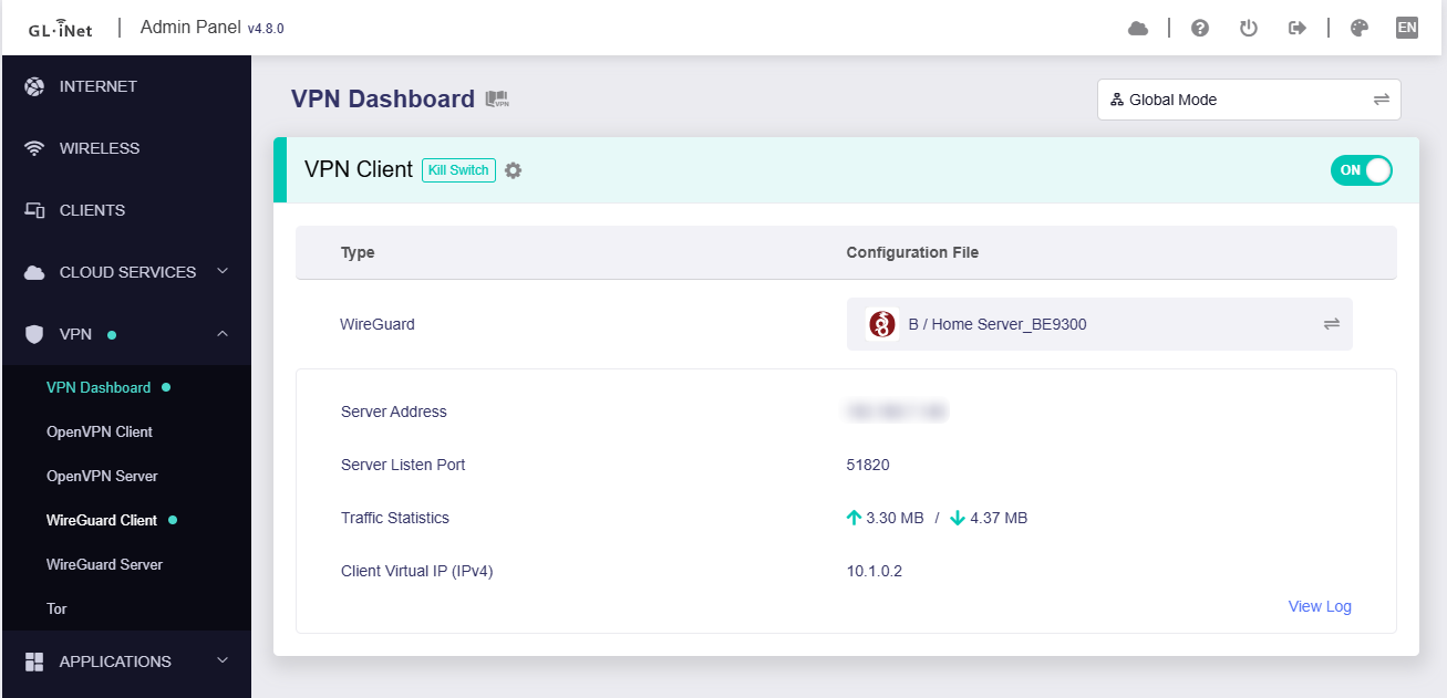

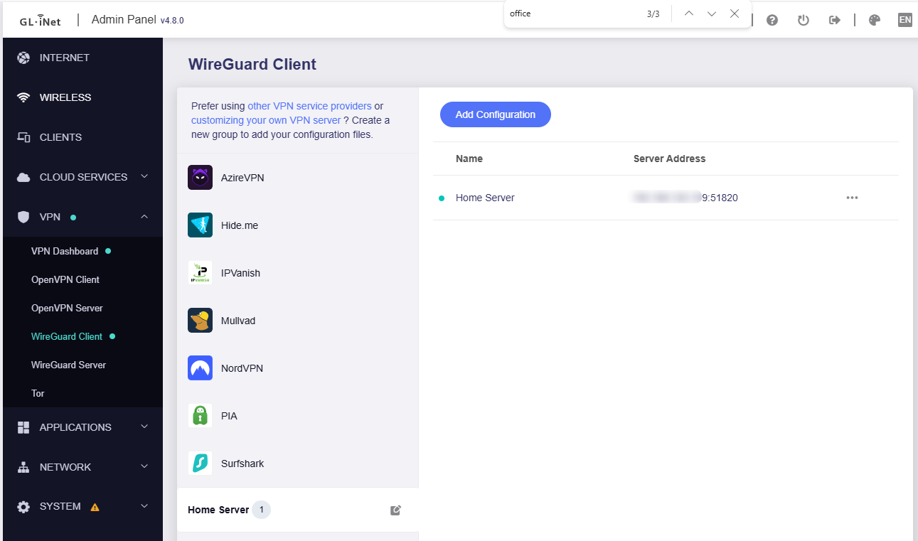

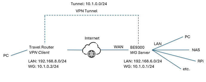

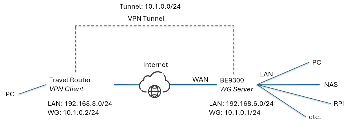

My test network topology:
The server have not changes, like last one reply.

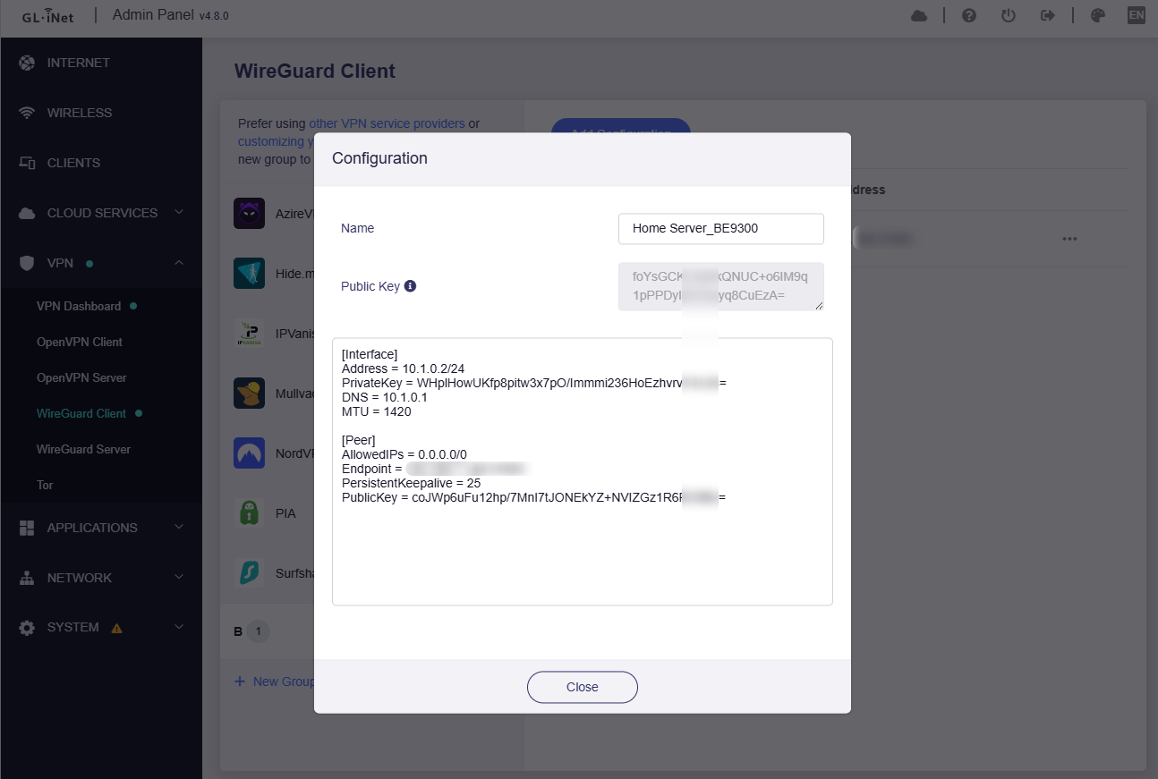

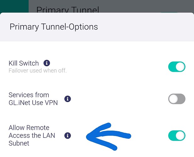

The client is MT3000 v4.8.0 r3, tested with the Global and Policy mode, and Kill Switch both enabled.
DNS is the server (BE9300) tunnel IP
The PC (LAN client) under the Travel router (VPN client):
