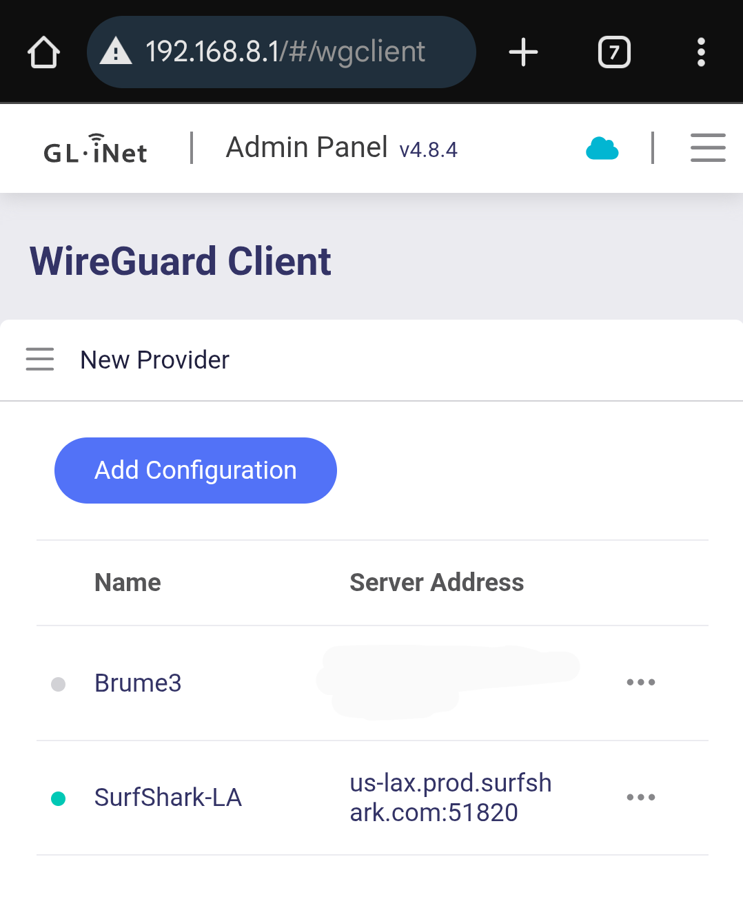

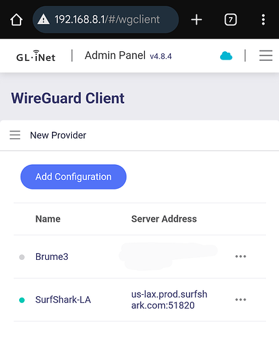

It is important in the dns settings inside the gl firmware you have it set to default value, not manual etcetera, the text explains it also about the wireguard tunnel dns.

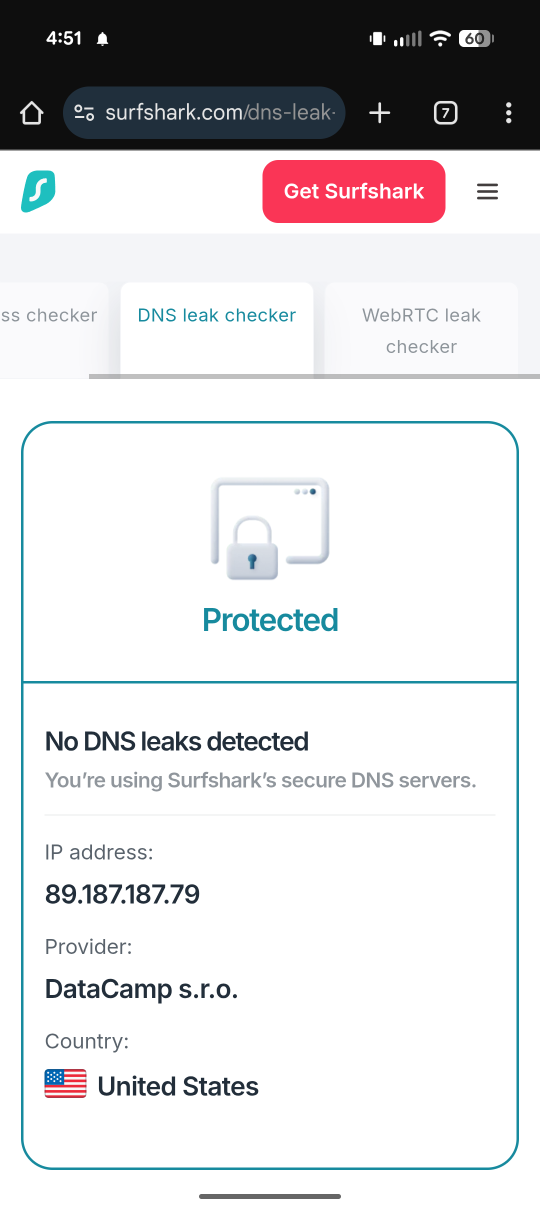

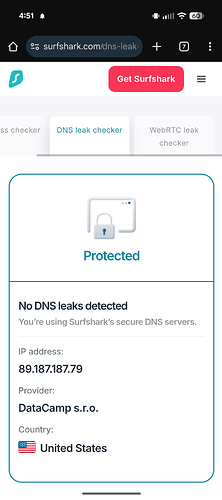

I've been using Mullvad VPN for a while and had no issues with DNS leak. I switched to PureVPN, then to SurfShark. Also no issues as well. :+1:t2:

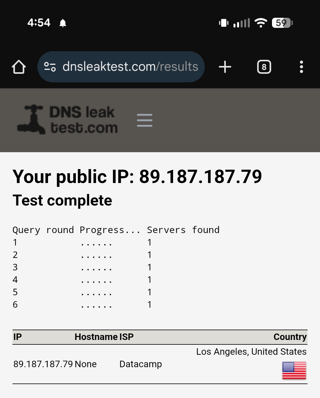

Here is my leak test, no problem on gl.inet device.
With that said, unless if you modified the DNS section in the wg.conf, I don't think these VPN companies will leak your DNS. More likely that you used a company app on your phone or SSID location.
