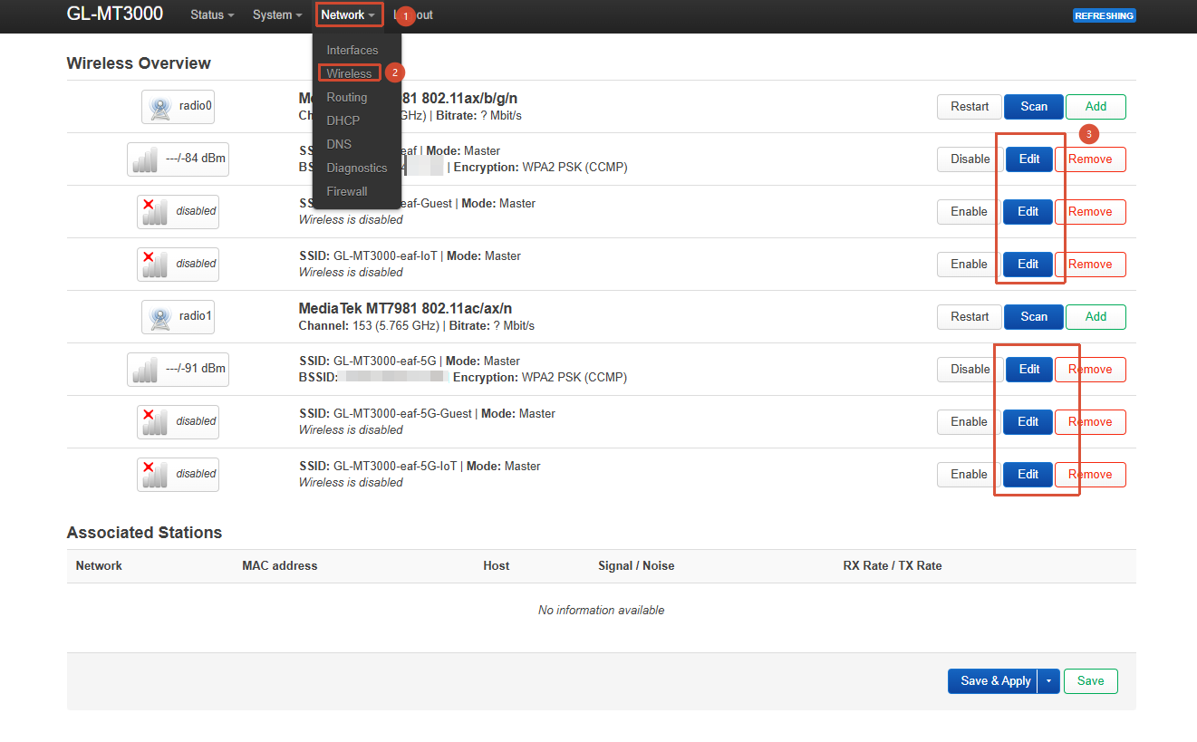

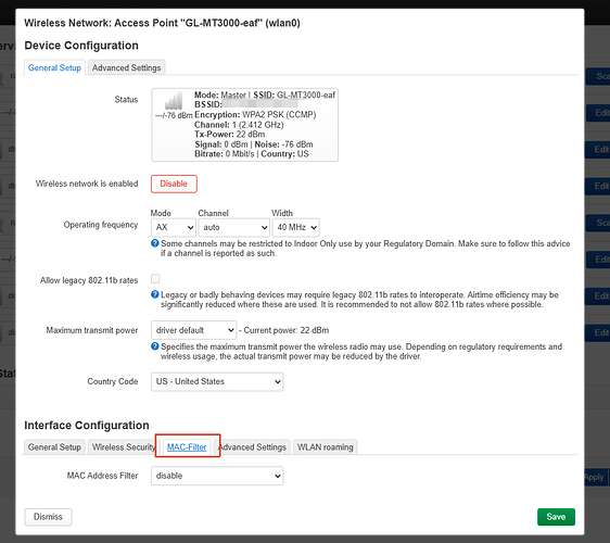

If you still prefer to use the Wi-Fi MAC filter list, you may need to consider using the OP24/25 version. Then you can add it in LuCI > Network > Wireless:
