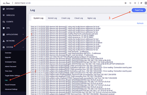

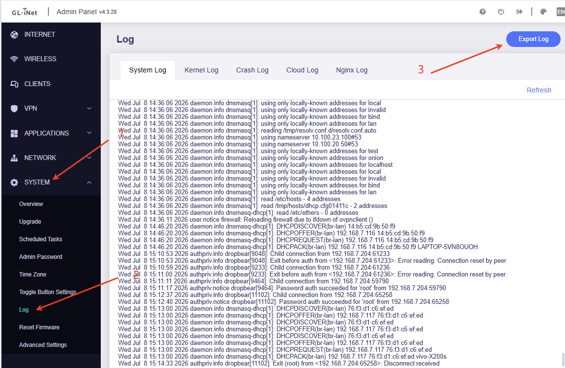

Please send us the test results and the exported logs via private message, so we can better help you troubleshoot the issue.
