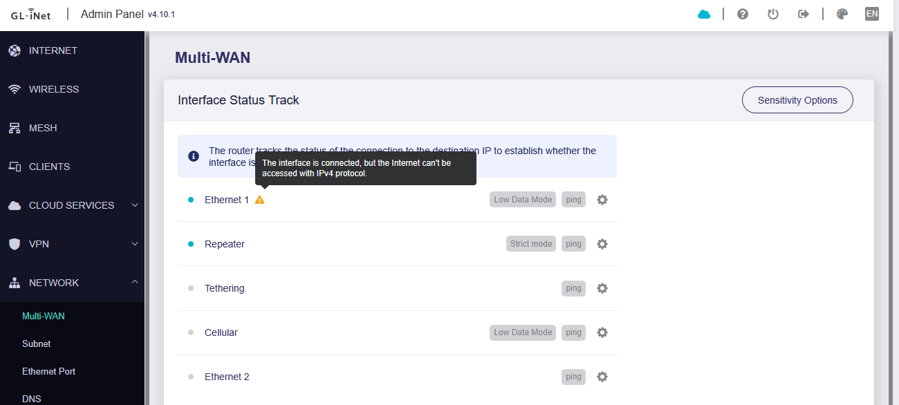

i have a Flint 3 at the latest stable firmware and i’m trying to use the connection from my provider, Sky Italia, using the MAP-T as described in their page.
I’ve tried both with the help of AI and following various discussion and guides for example:
But ending up swith the same situation and the issue persising, maybe because it’s about a different device or something else.
At this point i’ve reached this situation:
i have the Ethernet 1 port showing with a small triangle saying “The interface is connected, but the Internet can't be accessed with IPv4 protocol.”

I tried also installing the map module, but it was trying to create an interface wan4_6 that was keeping failing for the mapping, so i went in Luci, System, Software and looked for map and found that a package is already present for mapt (kmod-qca-nss-ppe-mapt) so i've removed map hoping to solve apossible conflict
At the moment in the GL-Inet admin panne i have:
  • ipv6 active in native mode with DNS authomatic
  • IGMP Snooping deactivated to avoid possible issues
  • Network Acceleration deactivated for same reason above
Please help.
