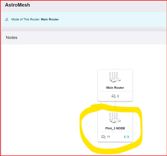

As the quote below this works for me SSH into the node :-
This works for me:
uci set system.@system[0].hostname='insert-hostname'
uci commit system
/etc/init.d/system reload

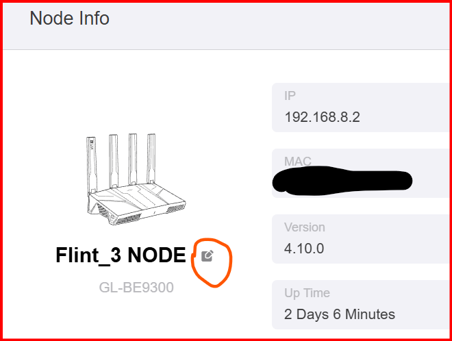

Or go to and click on the node :-1
Click the Edit button:-
and edit the name:-
Is that what you are looking for?

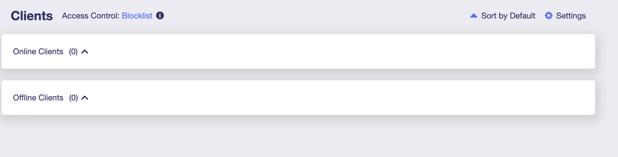

  • The client tab shows no clients. It did this when I first set it up and I rebooted it. The client tab worked for a while but then the tab is clear again. See the screenshot.
