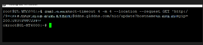

You still can bind a wan address of your choice with GLDDNS, thus bypassing inquiring an IP from the wan interface!
Check the steps I listed in this thread;

It didn’t work, I played the commands as instructed, but the error still appears in glddns pulling the fixed IP of my operator’s modem.
Did I do something wrong?
Even with the error of pulling the fixed IP that I put, the GL DDNS updated it to the new real IP.
You first enable the ddns from the web gui. Then you follow the commands I listed to override the bound ip in GL DDNS server.

But it will only work once, so you need to create a cronjob for that, am I right?
No, not needed as the binding is performed once when the switch is on.
admon
15
But if your ISP uses a dynamic IP - how will this change be populated to the GLDDNS?
It does not matter - binding from the shell will stay forever unless the switch is off and on again.

If his upstream gets an updated ip then he needs to re execute the command or create some job to detect it and bind it again.
huuum so basically this process is for fixed IP, dynamic it doesn’t make sense to keep placing the commands every time.
