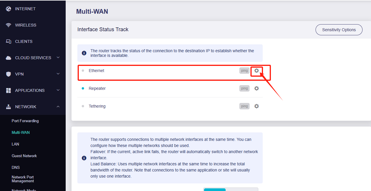

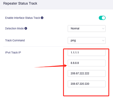

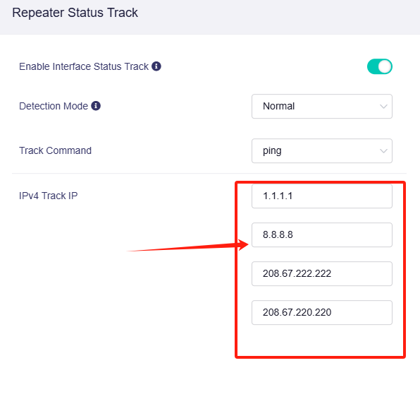

Please test ping the 4 DNS addresses in your router management page to see if there is any packet loss.
There may be a problem with the network export.

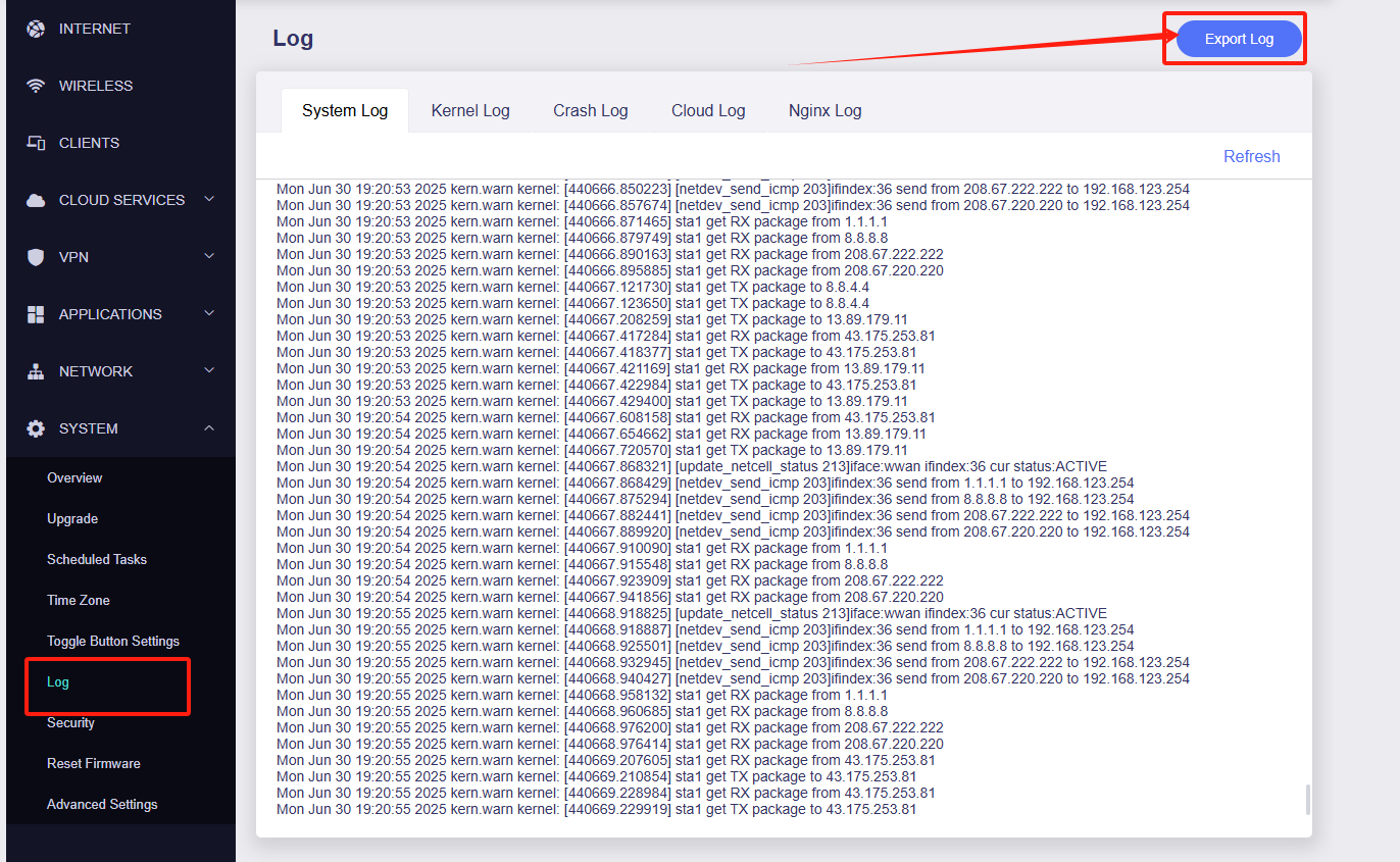

If possible, try to reproduce the problem and then export the log.

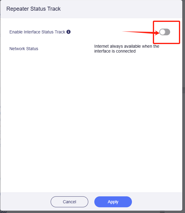

By the way, is your device able to access the Internet at all times? Even if it says "internet can't be accessed".
If this is the case, you can turn off "Enable Interface Status Track" and the router will no longer detect it, but you will also not be able to use Multi-WAN features such as failover and load balance.
