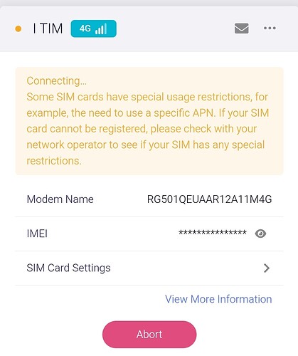

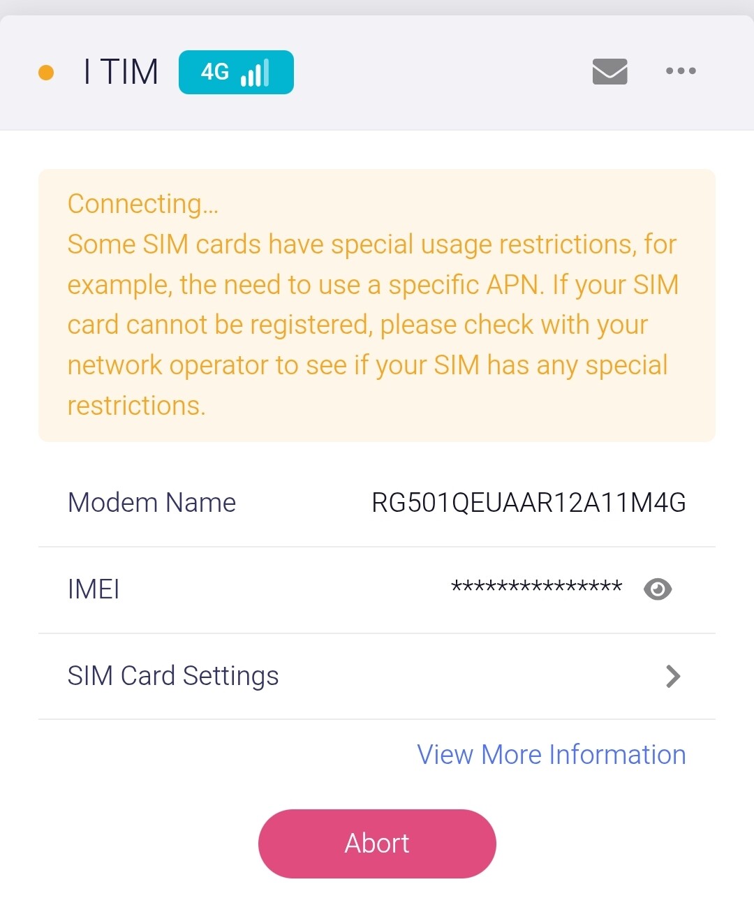

At first, the modem connected with MBIM, but it didn't last long; I couldn't connect again.

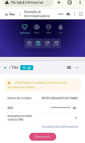

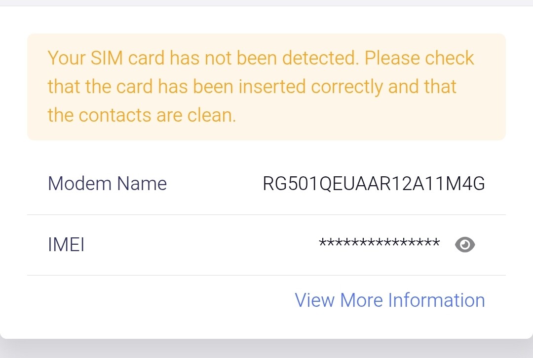

Then I tried it with QMI and managed to connect again, but I'm having several problems. Sometimes it connects, but if I restart the modem, it always gives me +CGFUN=0, and I have to manually reset it with AT+CGFUN=1.
It's difficult to connect, even if it detects the SIM card, and the cellular network can't maintain a stable connection. If I restart, +CGFUN=0 returns.

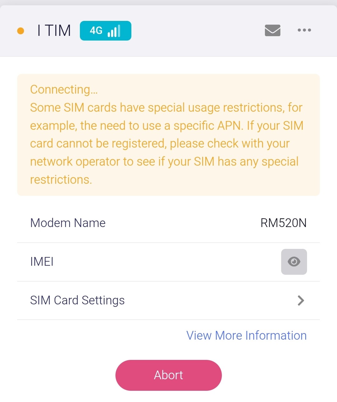

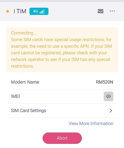

With the modem in QMI, I tried creating the interface in LuCi in MBIM. Upon the next restart, the modem is recognized as the RM520N model.
Now, strangely enough, it's been working and stable for a couple of hours now. Now the problem remains with CFUN=0 upon reboot. How can I force CFUN=1 automatically upon a reboot?

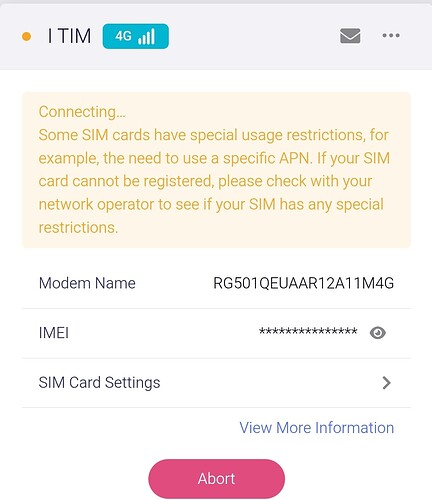

I applied this suggestion and the CTFUN=0 problem seems to be solved.
Now the connection problem remains.
Good—the startup workaround appears to address CFUN=0. The remaining issue must now be separated into mobile-network registration, QMI/MBIM mismatch, or USB power/disconnection. Please do not create an MBIM interface while the modem is operating in QMI mode.
After a failed connection attempt, post the non-sensitive outputs of these AT queries, together with the exact Beryl AX firmware version:
AT+CPIN?
AT+CEREG?
AT+CSQ
AT+QCFG="usbnet"
AT+CGDCONT?
Also check the kernel log for repeated USB disconnect / reconnect messages. If those occur, test with the independently powered modem carrier discussed above before changing software settings. Please redact APN details if they identify a private service; do not post full logs or device identifiers. The RG501Q-EU is not officially supported by GL.iNet. Any guidance is provided on a best-effort basis, and GL.iNet Technical Support may not be able to troubleshoot or maintain this configuration.

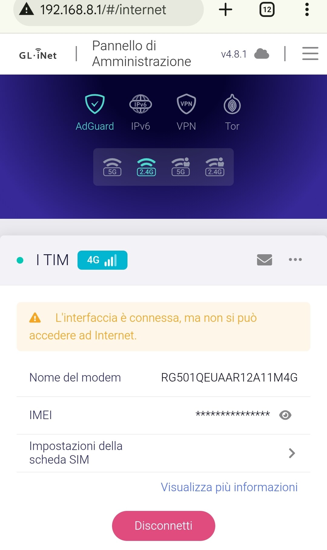

It's working. I deleted the interfaces I had created and/or modified. I rebooted the router without the RG501. Only then did I connect the modem (I had to set AT+CFUN=1), and the Beryl recognized and configured the modem correctly.
