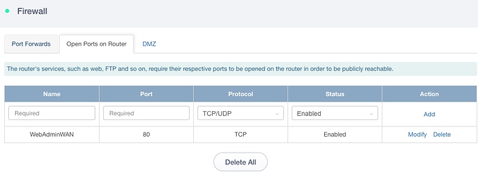

About your second question, The WAN IP of your MT300 is 192.168.1.120. If you want to be able to open the Admin Panel via web when typing that IP on your browser, you need to go to Admin Panel > Firewall > Open Ports on Router and enable port TCP 80.
Here a screenshot:

Thanks, opening port 80 on the GL-inet now I can see the admin panel of the VPN router from the 1st ISP modem router. But how safe is it opening port 80?
Not safe. Do not use 80 if not necessary.
