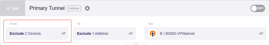

Please try switching VPN Mode to Policy, then set the Ring Cam to the exclude list.
