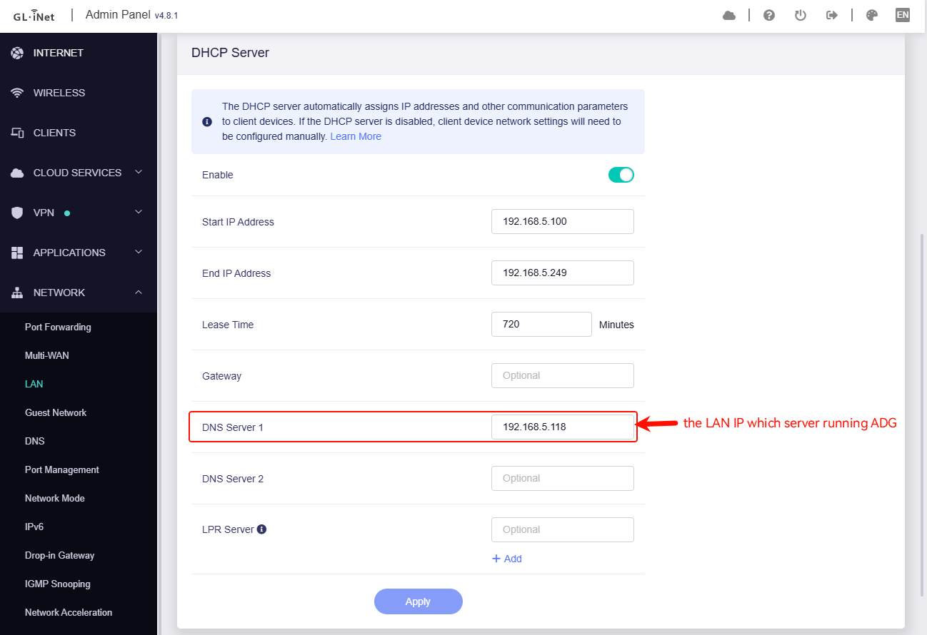

Hello, I've installed AdGuardHome in docker using a macvlan and disabled the AdGuardHome on the Glinet router.
Changed the DNS setting to manual and pointed it to the ipaddress of the AGH docker.
It works, but there's only one ipaddress (router) in the list of clients.
I remember the router had the same problem in the beginning. Maybe someone has a solution for that.
Here setup DNS server that point it to the AGH server, this will offer DNS to all LAN clients through DHCP server.
@bruce, thank you but I've already set the DNS there.
edit: I was wrong. I've set the DNS in NETWORK--> DNS
After I changed the DNS setting in LAN-->DHCP server-->DNS, it is working.
But, ofcourse it's confusing that a DNS setting, on different places, makes such a difference.
Ofcourse it's due to my lack of knowledge.
At the end, the result counts, Thanks again @bruce
