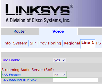

So I downgraded to 4.8.2, keeping all settings.
Still got “Failed” status at registration states for Line 1 and PSTN Line.
What I realized then was, that somehow the Line Enable status was reset from “yes” to “no”, so I changed that back. Absolutely don’t know, why that error occurred in the first place.
Status still didn’t change though.
So I set the SAS Enable to yes and the status did finally change back to “registered” for Line1 and PSTN Line.
Calls were however not yet possible with the SAS status at “yes”.
Changing it back to “no” fixed also that problem.
I tried upgrading the router to FW 4.8.3, had the issue once more and could fix it once more with setting the SAS Enable to “yes” and after getting the “registered" status, back to “no”.
