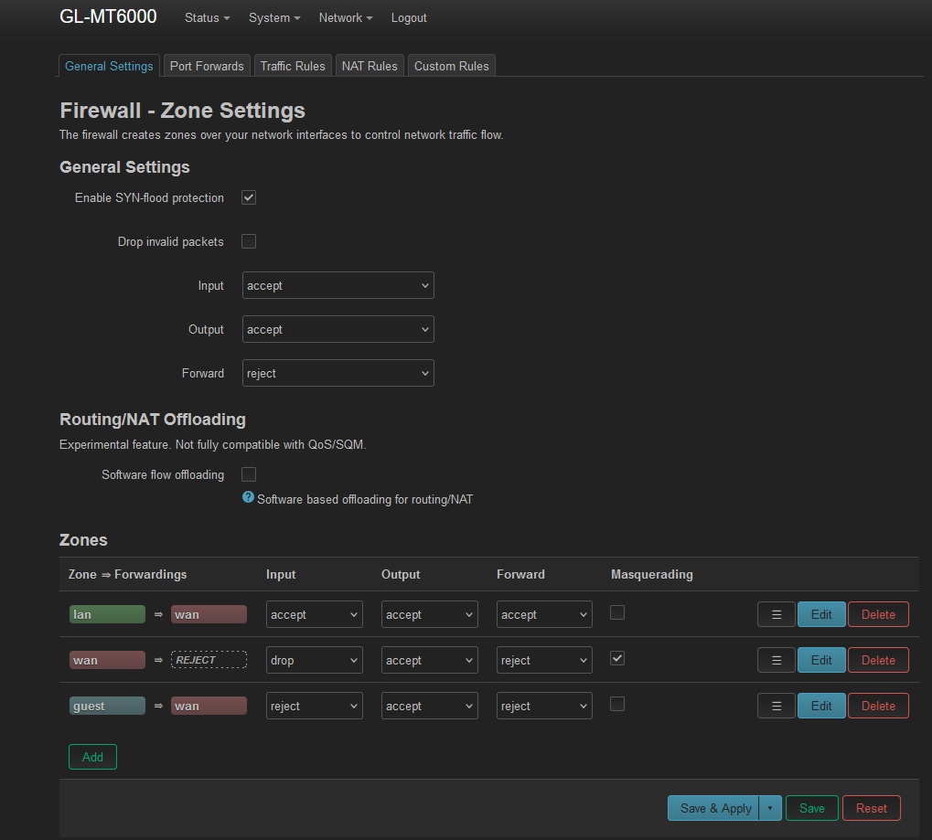

Just checking but no chance that the LuCI default settings could be an issue correct? It seems that most of these settings carry over from the GL.iNet Admin Panel
For example Forward is listed as reject
Under Zones
There is no
WAN => LAN accept
strong text
