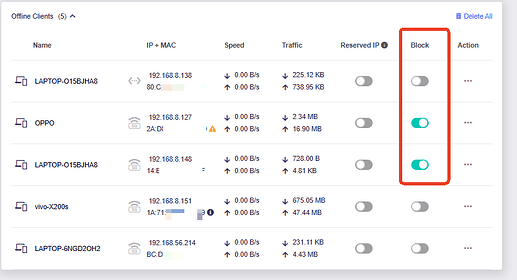

  3. Please check whether Access Control is enabled, and whether these clients are listed in the Blocklist or affected by Allowlist settings.

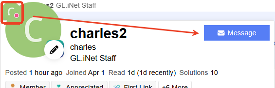

Could you please also export the system log after reproducing the issue and send it to us via private message. We will check the DHCP-related logs for further analysis.

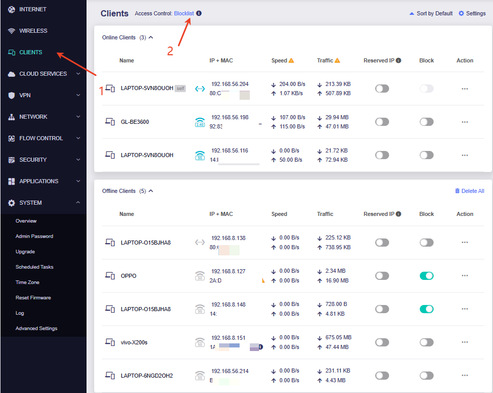

Thank you for the additional information.

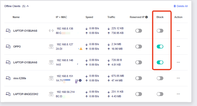

Since the same device can obtain an IP address normally when using a randomized MAC address, but cannot obtain an IP address when using its real MAC address, please check whether the real MAC address is affected by the Access Control settings.

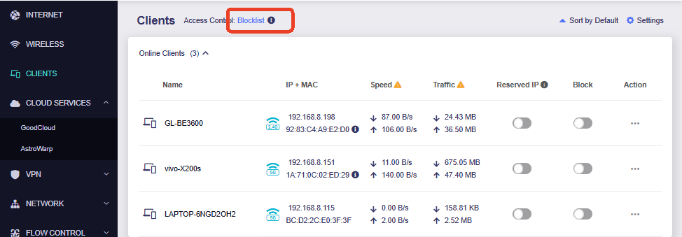

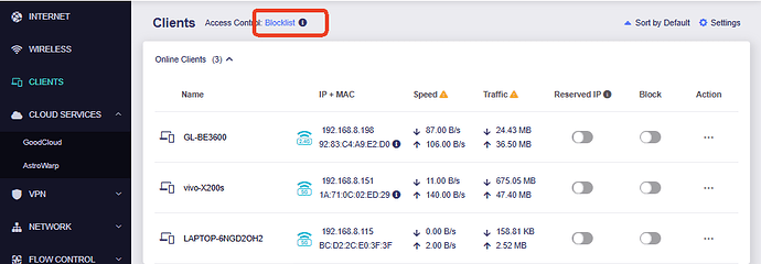

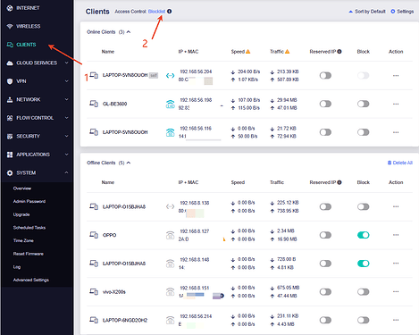

Please go to Clinet → Access Control → Blocklist and check whether these real MAC addresses are still listed there.
If the MAC addresses are listed in the Blocklist, please try one of the following:
Disable the Blocklist.
Or remove the corresponding MAC address entries from the Blocklist.
After removing the MAC address entries, please reconnect the affected devices and check whether they can obtain an IP address.
If the issue still exists after removing the Blocklist entries, please provide a screenshot of the Access Control page and the LAN DHCP settings page. We will further check the configuration.
Thank you for your cooperation and support.
Thank you for the quick reply. I discovered the issue to be trying to perform these actions via the web portal / browser. On the last two screen captures of how to remove the MAC address, could not be performed using the browser.
On the first screen capture you show the listed clients that are blocked, in my situation no clients were showing up in that list as being blocked, likewise on the mobile app. In the second capture, I could see the actual MAC addresses that were blocked however there was no way to remove them from the Access Control list. No way to select them to be removed.
The good news is, I was able to remove them using the glinet app on my phone from the Access Control page.
Devices are now able to connect.
