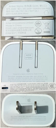

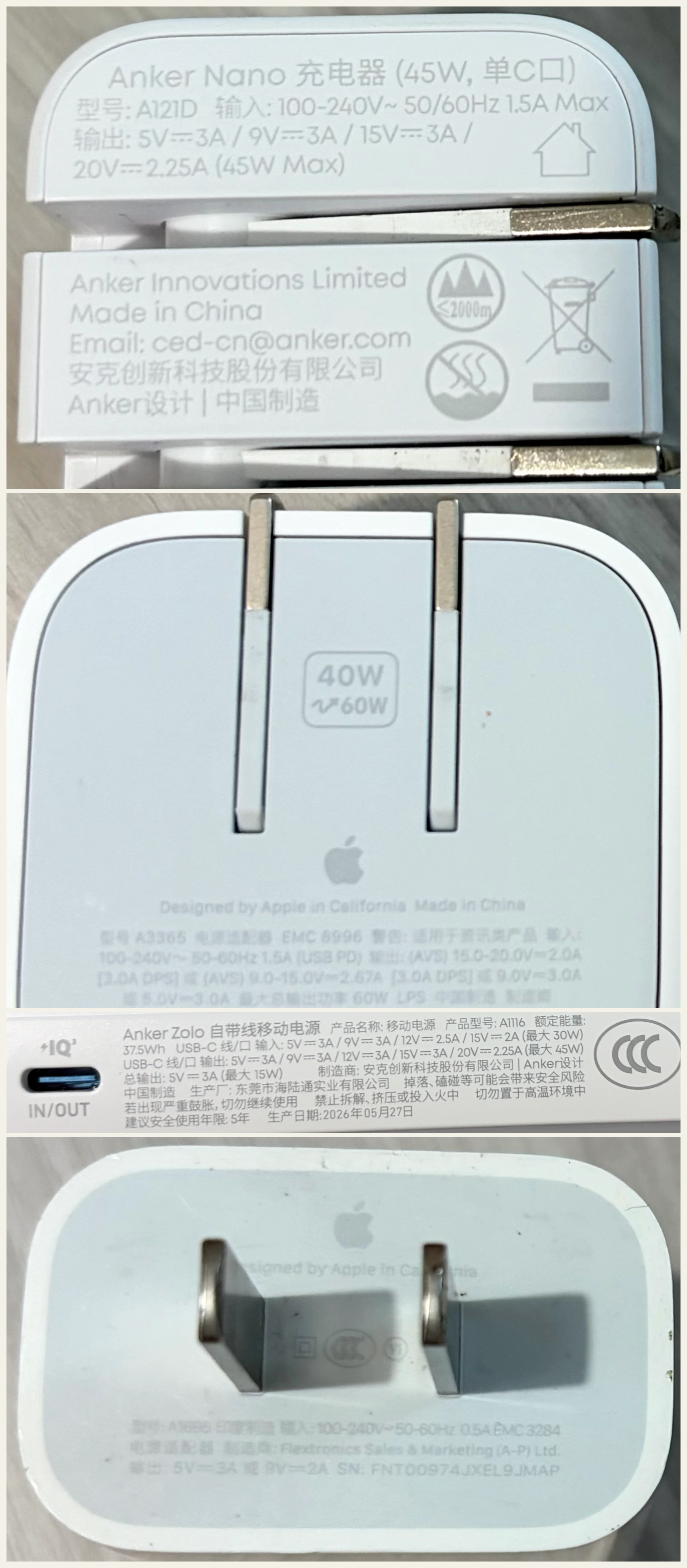

1、Anker 45W
2、Apple MacBook Air M5 original charger
3、Anker Power Bank
4、 Apple 20w Charger​:down_arrow:
And the chat history with ChatGPT
Apart from the Anker power bank, these chargers all have only one port.
I tried both USB-C ports on the Mudi7 and encountered the same problem.
Hopefully this will help to solve the problem.
