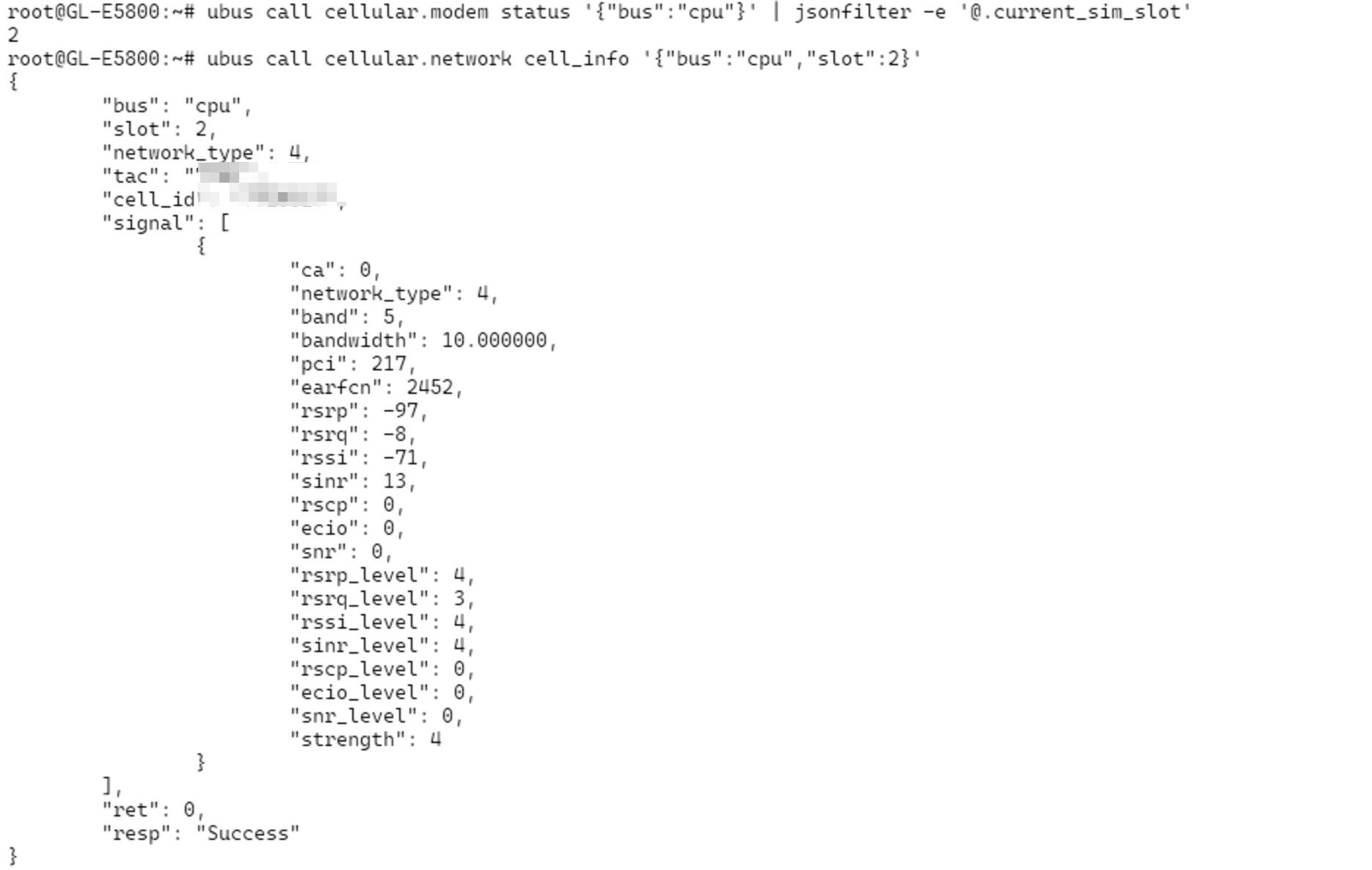

Yes, since we refactored some of the cellular-related features in v4.10 (users who have already tested it may have noticed significant changes in the related interface), the ubus interfaces have also been adjusted.
Currently, if you want to retrieve the SIM card signal information, please use the following ubus objects/methods:
# Check the currently used SIM slot:
ubus call cellular.modem status '{"bus":"cpu"}' | jsonfilter -e '@.current_sim_slot'
# Check the signal information for the corresponding SIM slot:
ubus call cellular.network cell_info '{"bus":"cpu","slot":2}'

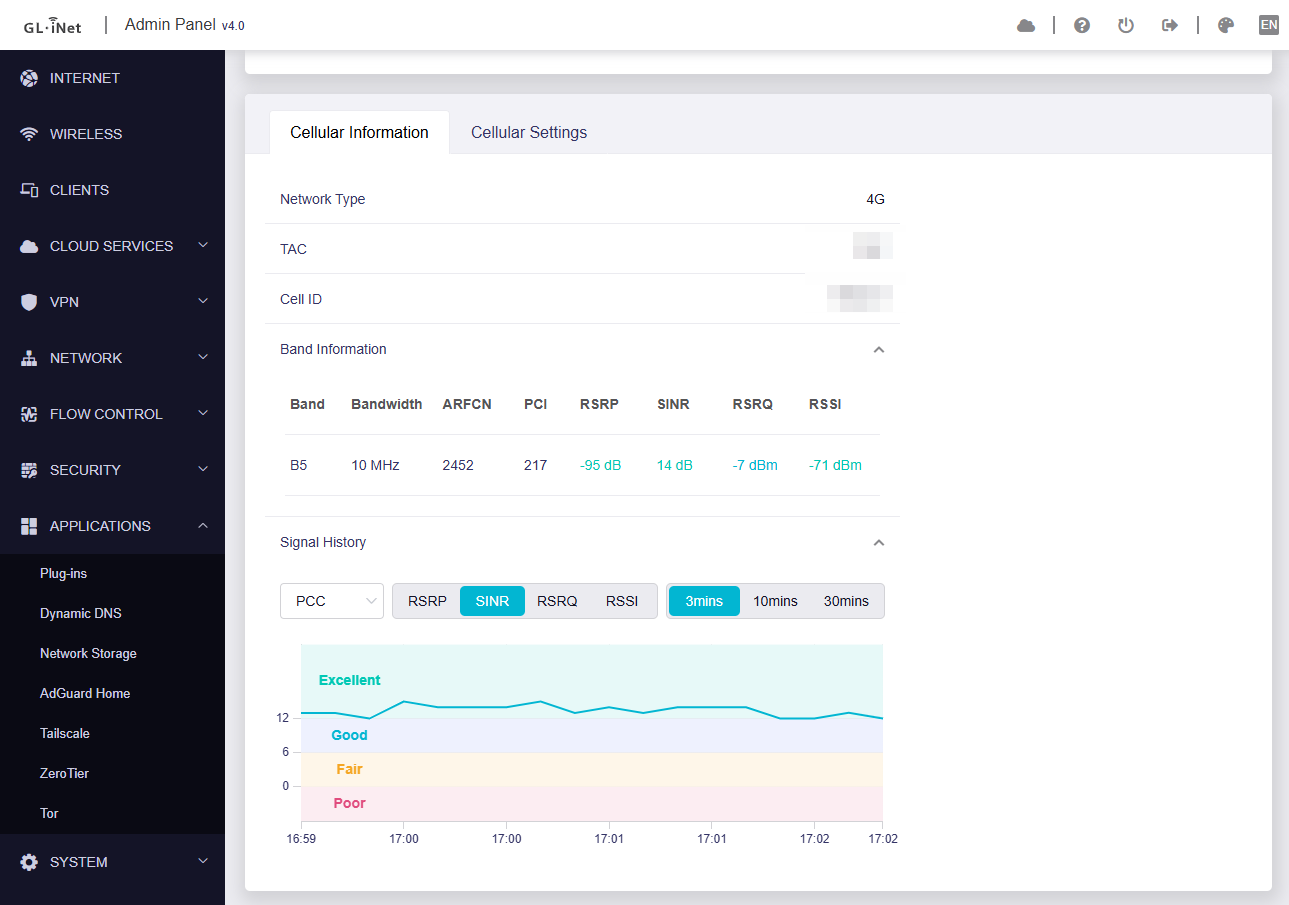

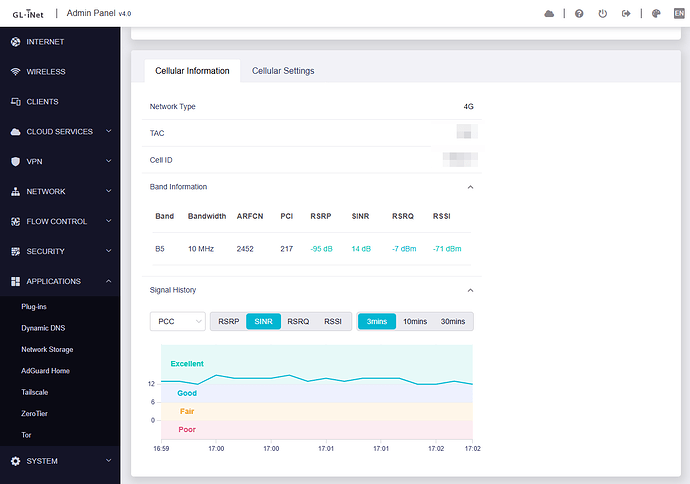

Additionally, the GL UI should have already been adjusted accordingly and should now be able to display the signal values correctly.
Are you encountering any issues with signal value display on E5800 v4.10? If so, could you please provide the exact path and screenshots so we can better investigate?

ubus call cellular.network cell_info '{"bus":"cpu","slot":1}'
returns a signal[] array with rsrp/rsrq/rssi/sinr and the *_level fields, and the GL UI signal display is working great here too.
In case it helps anyone else who finds this thread with a third-party dashboard showing empty signal: the values just moved to this new cell_info method in 4.10, so tools reading the older location need a small update. Nothing wrong with the firmware at all — just the new interface.
