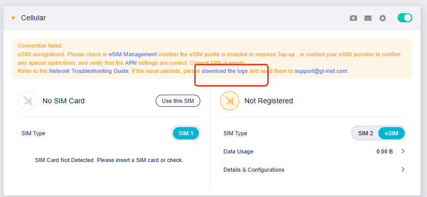

It seems reboot corrupts eSIM profile.
Another finding:
After the device exit from Low Power mode, the eSIM become unregistered even after Disable and then Enable it.
Need to delete the eSim profile and add it back.

Regarding the eSIM issue, could you please confirm whether it can be reproduced consistently? For example, does the eSIM become unregistered every time after a normal reboot and every time after exiting Low Power Mode, or does it only occur occasionally?

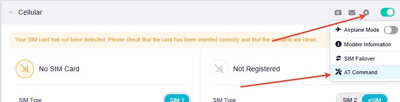

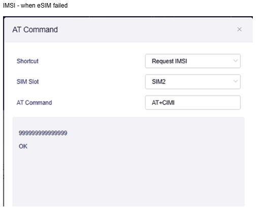

If the issue can be reproduced, when it occurs again, could you please provide a screenshot of the Cellular page showing the eSIM status, ICCID, IMSI together with the complete router firmware version and run the following AT command and share the result:
AT+QGMR;+CSUB

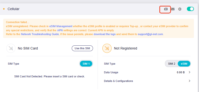

Is the Router Log can be found in SYSTEM - Log section? I only can see System Log, Kernel Log, Crash Log, Cloud Log and Ngnix Log.

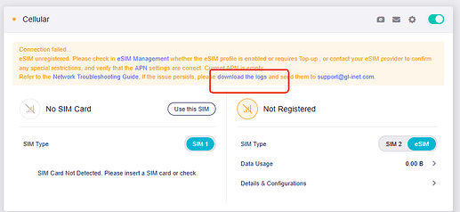

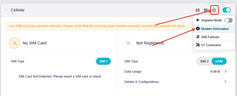

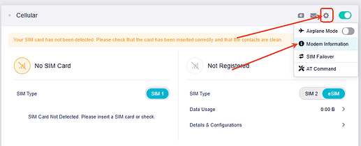

May I know where to find Modem Debug Info?
Please go to INTERNET → Cellular and click download the logs to export the Modem Debug log.
For the eSIM debug log. Please go to INTERNET → Cellular → eSIM Management and click Export Log For Support.

When the issue occurs, the modem returns 999999999999999 instead of a valid IMSI, which indicates that the eSIM information is not being read correctly at that time.
We are checking the behavior further with the relevant team. We will update you once we have further findings.
