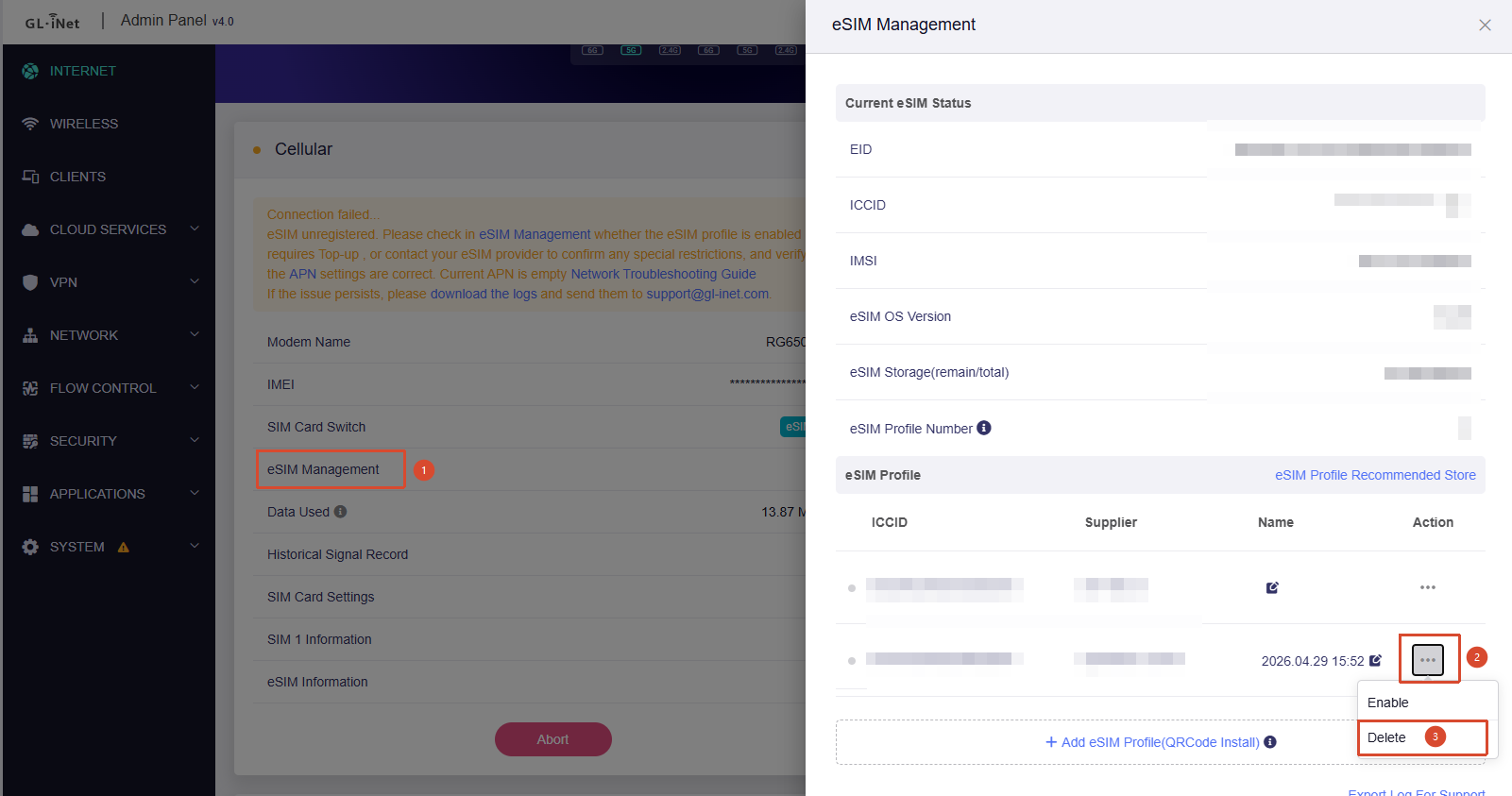

I can see no way of deleting a profile.
In the Admin Panel → Internet → eSIM Management, you can disable and then delete any manually added eSIM profiles:
Please note that the default pre-installed profile cannot be deleted.
