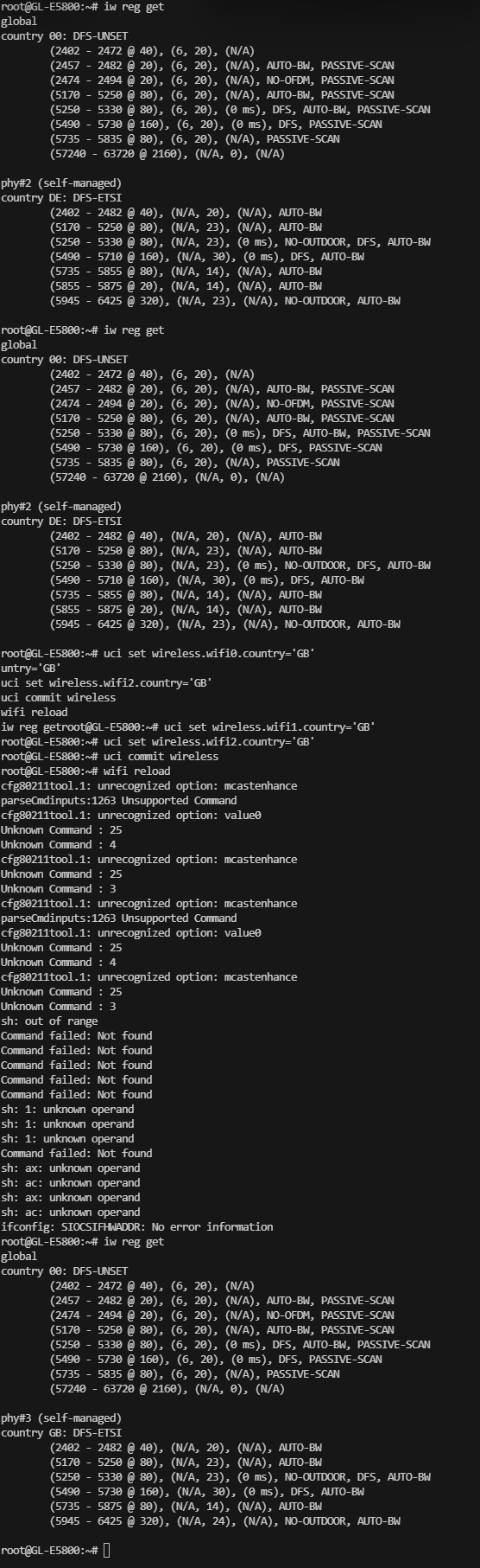

root@GL-E5800:~# uci show wireless | grep country
wireless.wifi0.country='GB'
wireless.wifi1.country='GB'
wireless.wifi2.country='GB'
root@GL-E5800:~# iw reg get
global
country 00: DFS-UNSET
(2402 - 2472 @ 40), (6, 20), (N/A)
(2457 - 2482 @ 20), (6, 20), (N/A), AUTO-BW, PASSIVE-SCAN
(2474 - 2494 @ 20), (6, 20), (N/A), NO-OFDM, PASSIVE-SCAN
(5170 - 5250 @ 80), (6, 20), (N/A), AUTO-BW, PASSIVE-SCAN
(5250 - 5330 @ 80), (6, 20), (0 ms), DFS, AUTO-BW, PASSIVE-SCAN
(5490 - 5730 @ 160), (6, 20), (0 ms), DFS, PASSIVE-SCAN
(5735 - 5835 @ 80), (6, 20), (N/A), PASSIVE-SCAN
(57240 - 63720 @ 2160), (N/A, 0), (N/A)
phy#0 (self-managed)
country DE: DFS-ETSI
(2402 - 2482 @ 40), (N/A, 20), (N/A), AUTO-BW
(5170 - 5250 @ 80), (N/A, 23), (N/A), AUTO-BW
(5250 - 5330 @ 80), (N/A, 23), (0 ms), NO-OUTDOOR, DFS, AUTO-BW
(5490 - 5710 @ 160), (N/A, 30), (0 ms), DFS, AUTO-BW
(5735 - 5855 @ 80), (N/A, 14), (N/A), AUTO-BW
(5855 - 5875 @ 20), (N/A, 14), (N/A), AUTO-BW
(5945 - 6425 @ 320), (N/A, 23), (N/A), NO-OUTDOOR, AUTO-B

I have the same issue, GB reporting as DE and loss of 5GHz wifi channels 149-165
We tested this behavior on an EU version of Mudi 7 with firmware v4.8.5, and we were able to change the Wi-Fi regulatory domain from DE to GB successfully.
Could you please try applying the following commands again and check whether the result changes?
uci set wireless.wifi0.country='GB'
uci set wireless.wifi1.country='GB'
uci set wireless.wifi2.country='GB'
uci commit wireless
wifi reload
