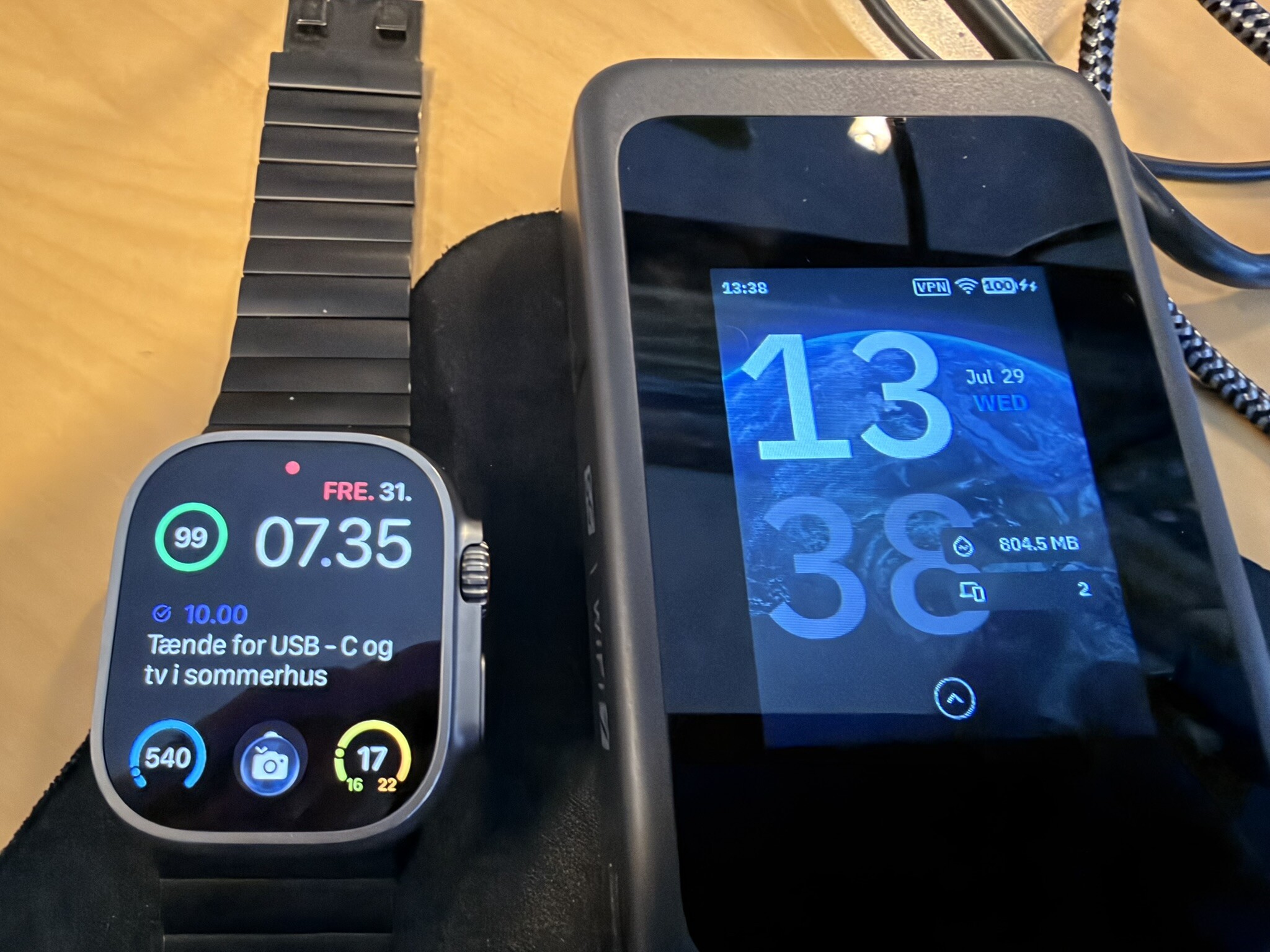

  1. The router is powered off, and I turn it on in the morning, when I arrive at work, where it connects to the guest network. The time over day, when corrected is precise. But again please remember. It’s not a timezone issue because both hours and minutes is out of sync, so not just - some hours but some hours + some minutes

Hi.
here are the results of the SSH commands - I also attached a picture of my watch compared with the time in the MUDI 7.

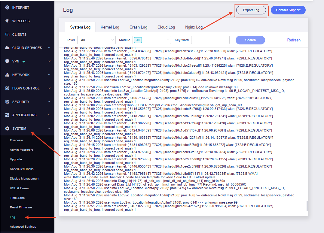

Before changing the time zone or running any recovery commands, could you please go to SYSTEM → Log, export the complete log, and send the exported file to us via private message.
After exporting the log, could you please wait until both the Wi-Fi connection and the VPN client show as connected, and then run the following commands through SSH?
/etc/init.d/chronyd restart
sleep 5
date -R
These commands will only restart the time synchronization service and will not modify or disconnect your VPN configuration. After running the commands, please let us know whether the system time returns to the correct value.
