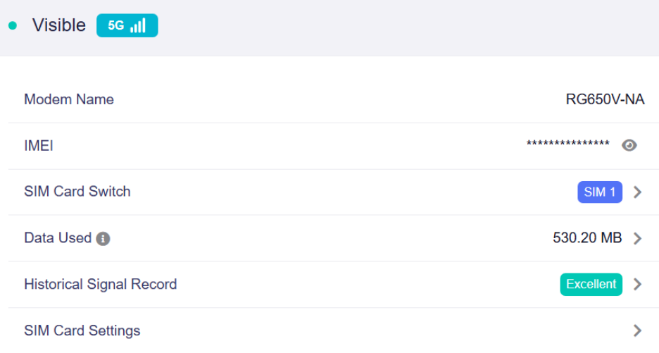

I’m currently facing issues with a Visible physical SIM card in my GL-E5800 Mudi 7.
I successfully spoofed the IMEI of a Google Pixel 3a onto my Mudi 7, but unfortunately, I’ve been throttled to only 10 Mbps.
The same PSIM on the Google Pixel 3a reaches 79.7 Mbps and 3.16 Mbps, with peak speeds of 125 Mbps.

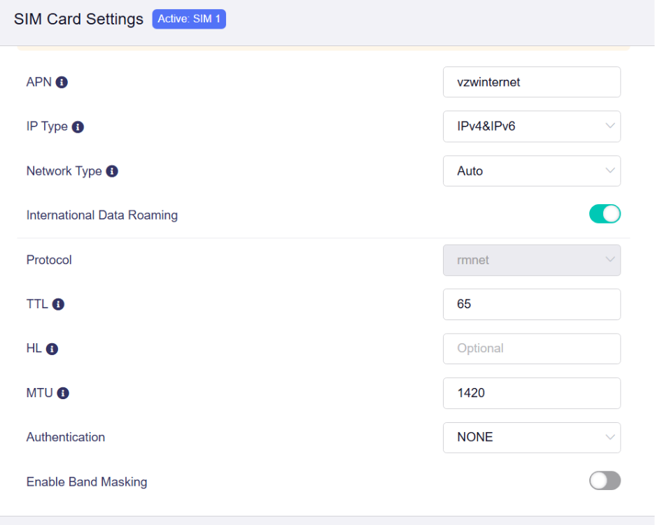

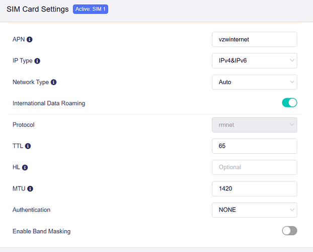

Here’s what I’ve done so far:
TTL set to 65
MTU set to 1420, 1428
I haven’t been able to achieve the desired SIM voice speeds.
Has anyone had success with the Visible PSIM? I'm open to any suggestions you may have.

Had to set TTL and HL (IPv6) to 88. 65 doesn’t work anymore.
Also, had to change the APN from ‘internet’ to ‘VZWINTERNET’ because when on the ‘internet’ APN, downstream would be fine, but after about 60s, the upstream becomes throttled to “hotspot” speeds (e.g. 2-5 Mbps). Changing the APN to ‘VZWINTERNET’ solved the upstream/upload throttle.
