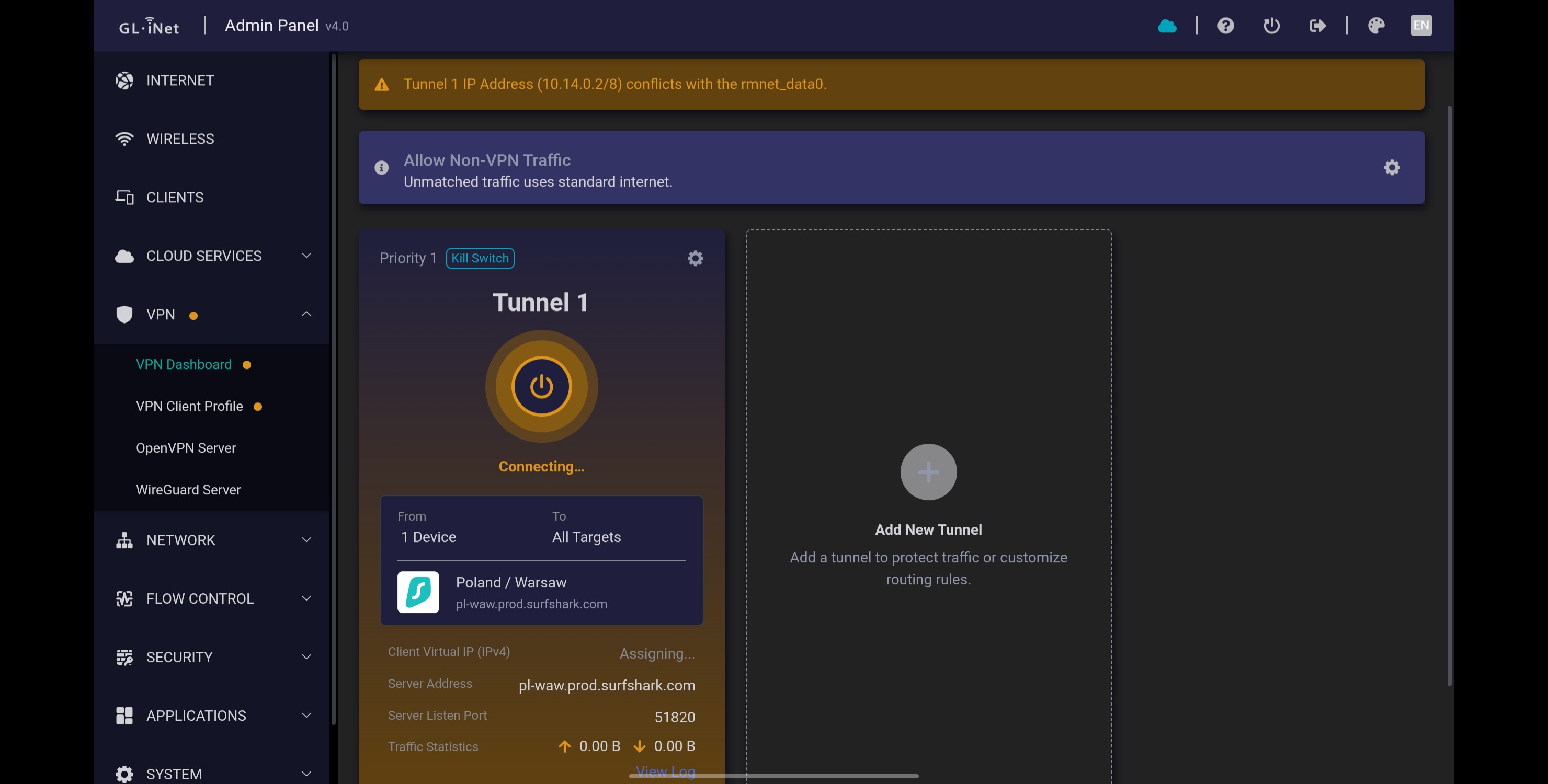

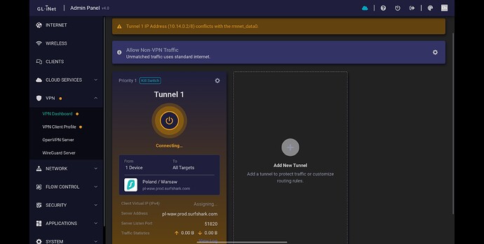

Error:
Tunnel 1 IP Address (10.14.0.2/8) conflicts with the rmnet_data0.
