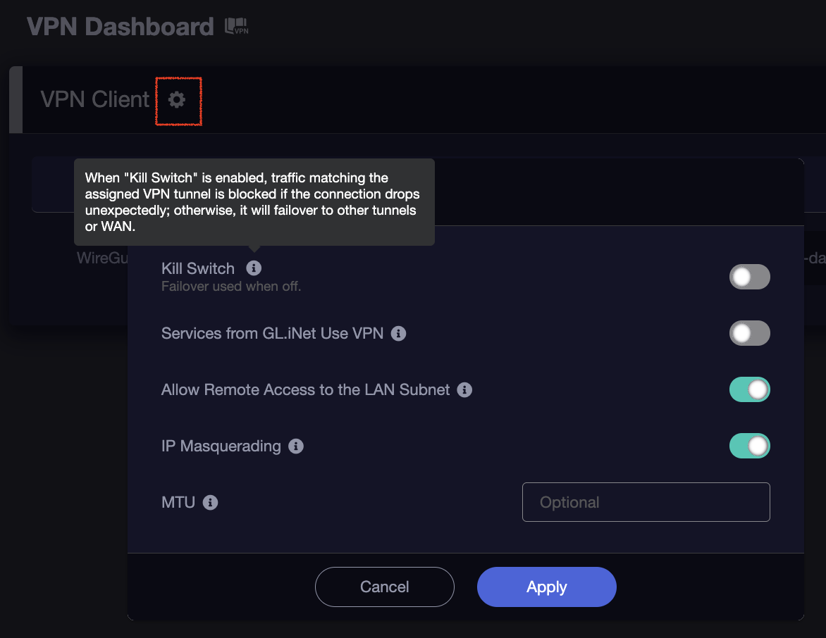

Try disabling the Kill Switch and see if will work.
Thanks for your response — I missed this configuration button:
But there was no success. The internet is still unavailable when the VPN is on:

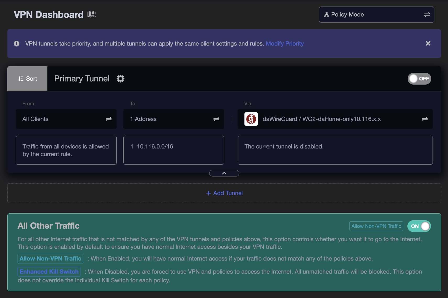

I disagree. Kill-switch has nothing to do with it.
In the top-right of the "VPN Dashboard" you have "VPN Mode". Likely you have selected "Global mode". That mode means: Route all traffic through the VPN tunnel.
At the same time your VPN says:
AllowedIPs = 10.10.0.0/16
and is therefore blocking all internet traffic send there!
For what you need, you want "Policy" mode. In there you can define that traffic from all clients for just 10.10.0.0/16 needs to go through that VPN. All other traffic should just go the normal way.
This isn't a kill-switch issue, but a routing issue...
Many thanks — I hadn't seen that configuration before - its working now.
