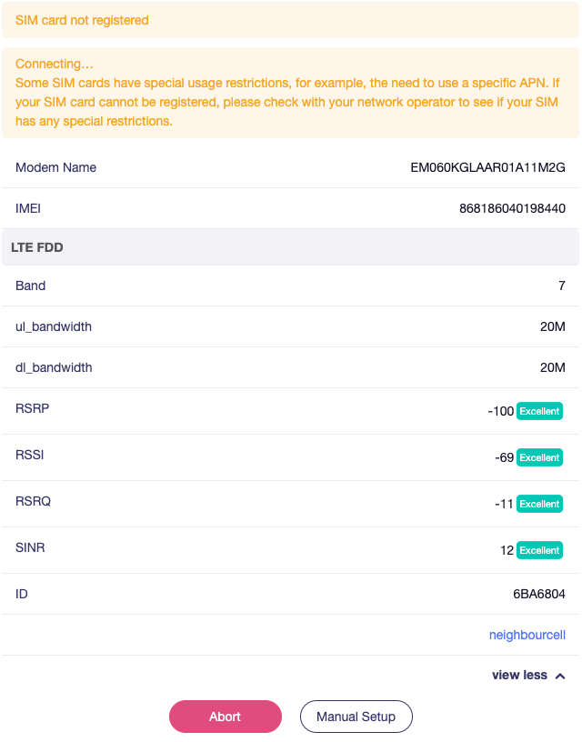

Hi All. I have the latest firmware, this is my first time using this device and i keep getting this error. I have tried several sim cards that I know work and I have used in mudi v1 and for some reason I can not get it to work. I have tried changing imei and updating or downgrading the firmware and still the same.
What could be the issue?

Yes the do work. I have other mifi devices that I have used these sims on. I have a mudi v1 and works in there.
I even changed the imei to see if that is the issue and it does not seem to be. The device is brand new and this is my first time using the v2 and there seems to be an issue.
I have checked online and this seems to be a ongoing issue.

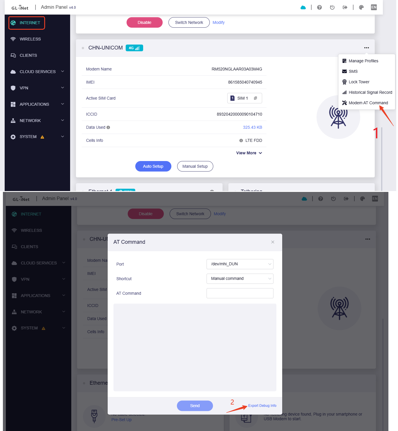

  1. Please check the modem status and SIM status using following AT commands in Admin Panel > Internet > Modem > ··· > Modem AT command:
AT+CFUN?
AT+CSQ
AT+COPS?
  1. Please export modem-debug info from Admin Panel > Internet > Modem > ··· > Modem AT command:
  2. Please export the system log (logread.tar) from Admin Panel > SYSTEM > Log
  3. Your use region and SIM card operator
  4. Please share the above results through PM me or email support@gl-inet.com, our cellular technical expert will take care this question.
Hi Bruce. Attached are the log fines you requested as well as some screenshots of the sim status.
I have used these sim cards on Another mudi that I had and never had any issues. I purchased v2 and I have not been able to get the sim card to work.
